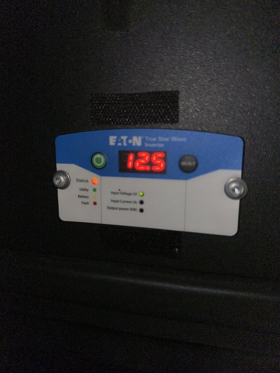

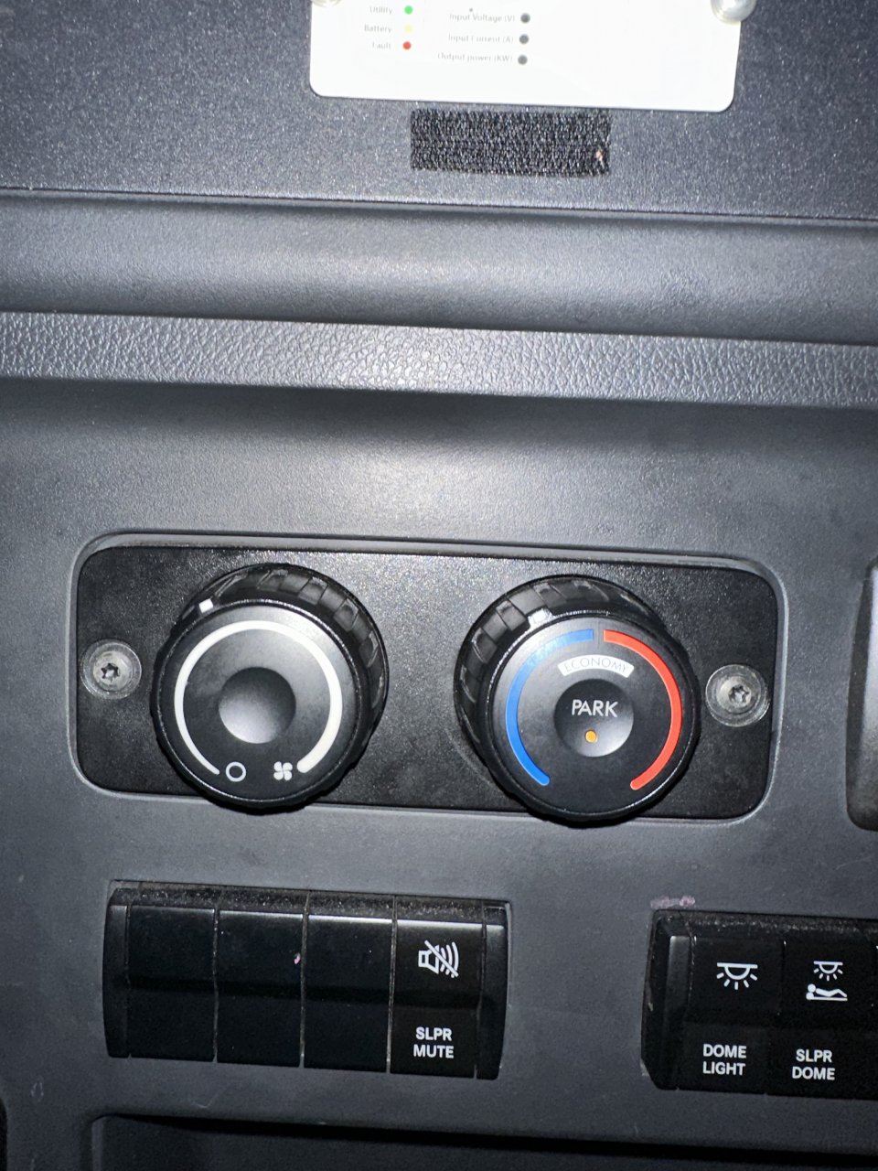

    My is my current 2022 truck at 9 hours in sleeper running electric A/C plus the factory refrigerator plus a CPAP off the factory inverter
    It cool in truck with those settings on thermostat for sleeper.
