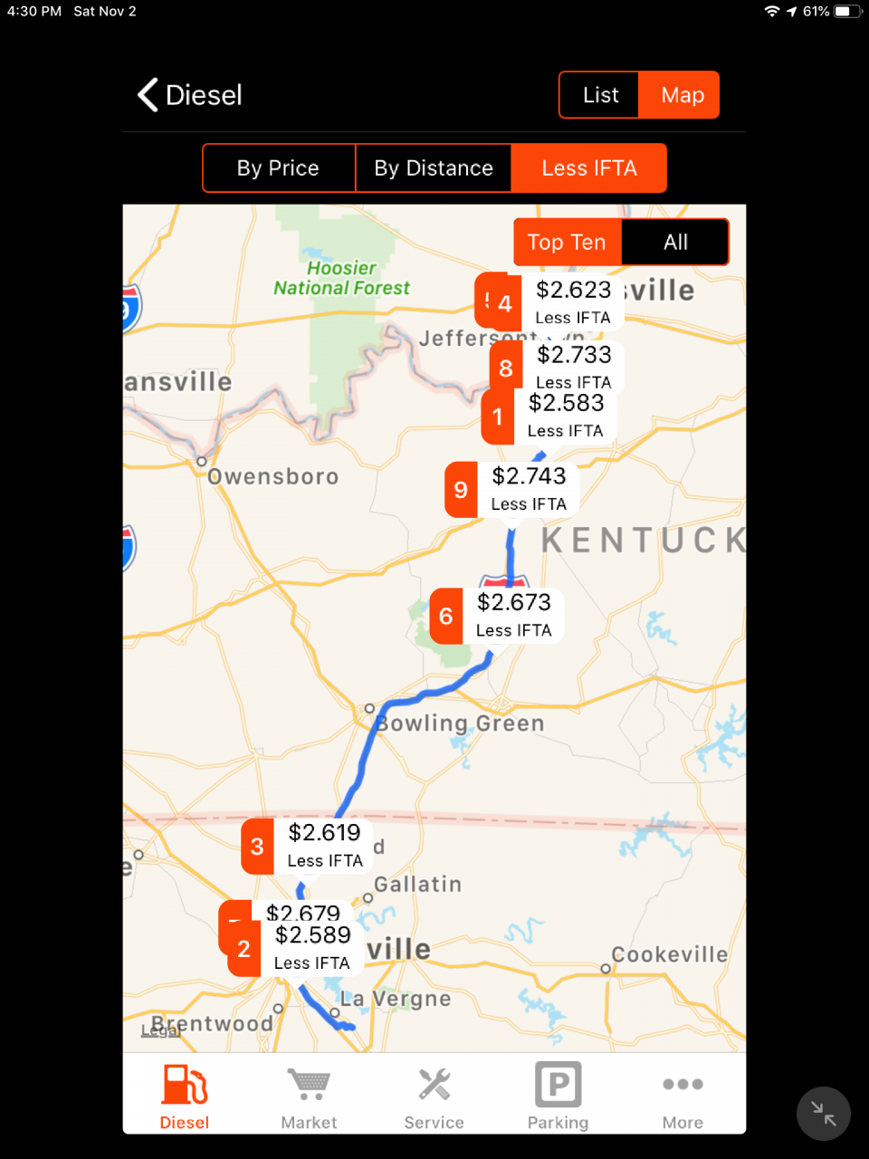

    This free app may help you with your fueling choice. It gives you the option to choose lowest pump price or less IFTA. In your case you will choose less IFTA. 5D17004A-D790-4BB1-91CC-C9663841CE20.png 59D34E66-A21C-4B37-B53F-D05ABADB6DD8.png

    It has been a long time since I filed IFTA, but the way you save money is to buy the cheapest before tax fuel. The state will get their taxes no matter what. There is an app for that. Can't remember which one I'm sure someone will post it.
    The cheapest before tax fuel right now is in Texas. So if you only fuel in Texas and drive everywhere (I know not possible) you will owe money to all the other states, but you will still pay less for fuel + taxes at the end. Remember the state will get their tax buying fuel there or not and the extra tax you paid Texas will be credited back to you.
