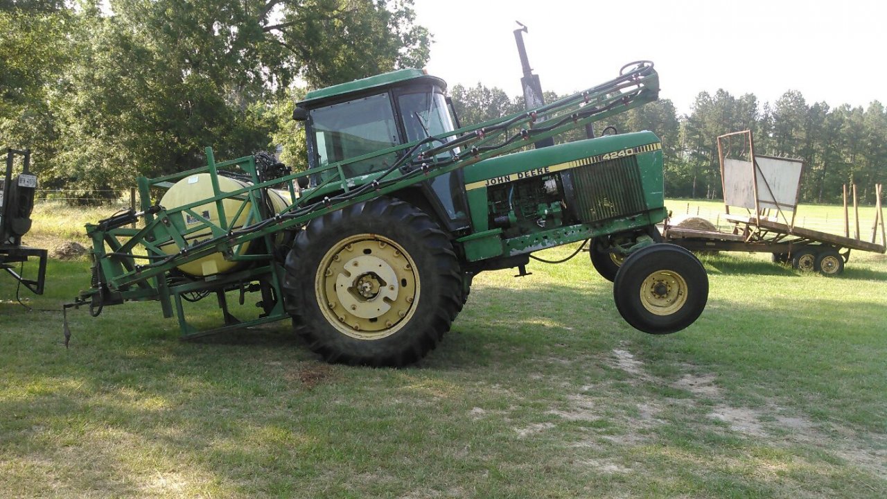

    Having the wrong equipment can be a lot more expensive in the long run if it is not up to the job. KIMG1420.jpeg This is my last problem like that. I already had the mule and could just unload the wagon a bit. You do not have that option.
