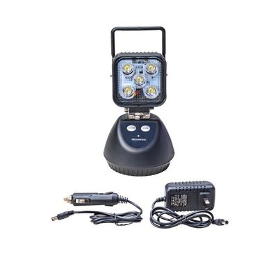

    Me? I just bought the Wolo 6000 "See-More" worklight.
    LED lights, over 1000 lumens
    Magnetic mount.
    Rechargeable by 110v or 12v (both chargers included)
    I plan to attach to DOT bumper when I'm backing into that last (dark) spot at the truck stop, at 2 am.
