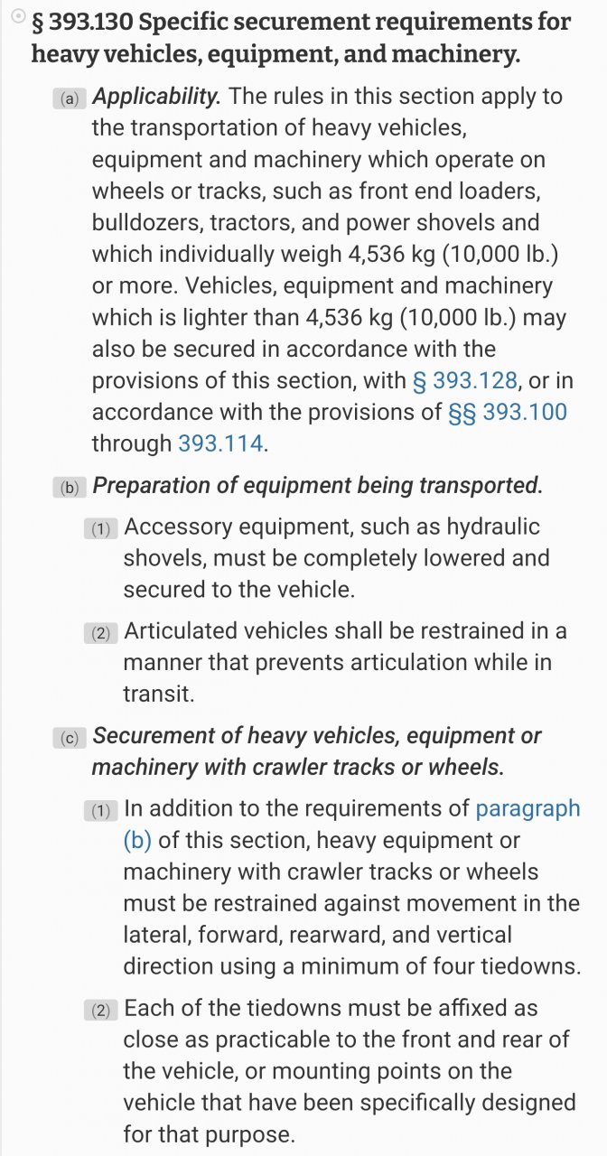

    I would say that @Oldman83 post above showing both chains to the single center point is 4 tiedowns per 393.130(c)(1) and those tiedowns are attached to a mounting point specifically designed for securement per 393.130(c)(2).

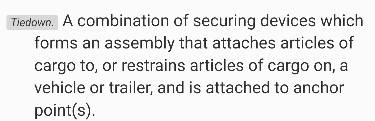

    The definition of a tiedown from 393.5:
    Again nothing about the anchor point is included. Only covers the chain/binder.

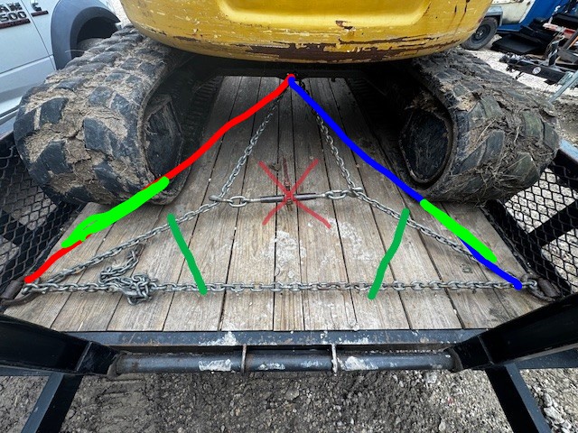

    2 chains pulling forward and to the sides in front. 2 pulling back and to the sides on the back. Another chain or strap over the bucket or whatever attachment is on the end of the boom. That would be enough to legally secure this machine.

    Cut that chain you have in half and put a slip hook on one end that you can easily hook into the center anchor point. The other end you hool to the d ring on the trailer and use 1 binder per side to go back to the d ring.
    Like this:
    Red and blue are individual chains. Green is a binder.
    They might touch the tracks a little but the chain won't hurt that track at all resting against it.

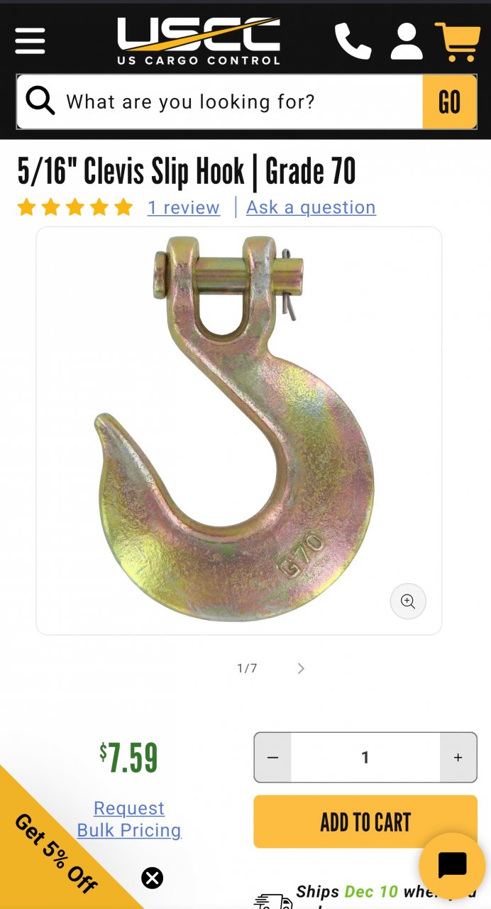

    The only cost to doing this is getting 2 more binders and 4 slip hooks.
    That piece of plate steel on the track frame is stronger than the 2 chains you will have hooked to it. If you manage to rip it off you are already having a very bad day.

    Your quote in 393.130(c)(2) is the section, as the points that have been specifically designed for that purpose. This question comes up, because he's trying to NOT use the attachment points that were designed for this. We can go round and round on the point of the 4 tiedown locations, since I've seen DOT officers cite the "independent" points for the 4, and although, a single point may be used, it also is supposed to be designed for that purpose. If that point is not designed to be able to hold that equipment, it does not qualify, just as any anchor point that does not meet required code can not be considered an anchor point for purposes of securement if it is not rated.
    All rolling stock (of any size) from my understanding has always had the ideal securement focus to be immobilization by way of the 4 points/corners. We can again argue and disagree, but the question was ..."Is this legal?", and considering we don't know what the rating of that contact point was, if there were other ways to get to an anchor point that although inconvenient or difficult, was discarded so they could "do it an easier way" again, doesn't make it legal. Your assumption, is that the point is legal. I propose it is not. Neither of us knows....but as @TripleSix was pointing out the reason for the OP's question, shouldn't it be on the OP to point out the securement point and whether it was legal? I wasn't going to assume it was, since by his own admission, he could not "properly" at the "mounting points on the vehicle specifically designed for that purpose", secure the vehicle.
    I've secured vehicles large and small also, but I also did so knowing the proper anchor points, and their ratings, so I can't in good conscience say yes. All you did was let him think it was legal, without knowing. I thought the point of helping people was to help them do the job safely and properly, not what ever works or is easiest, legal or not.
