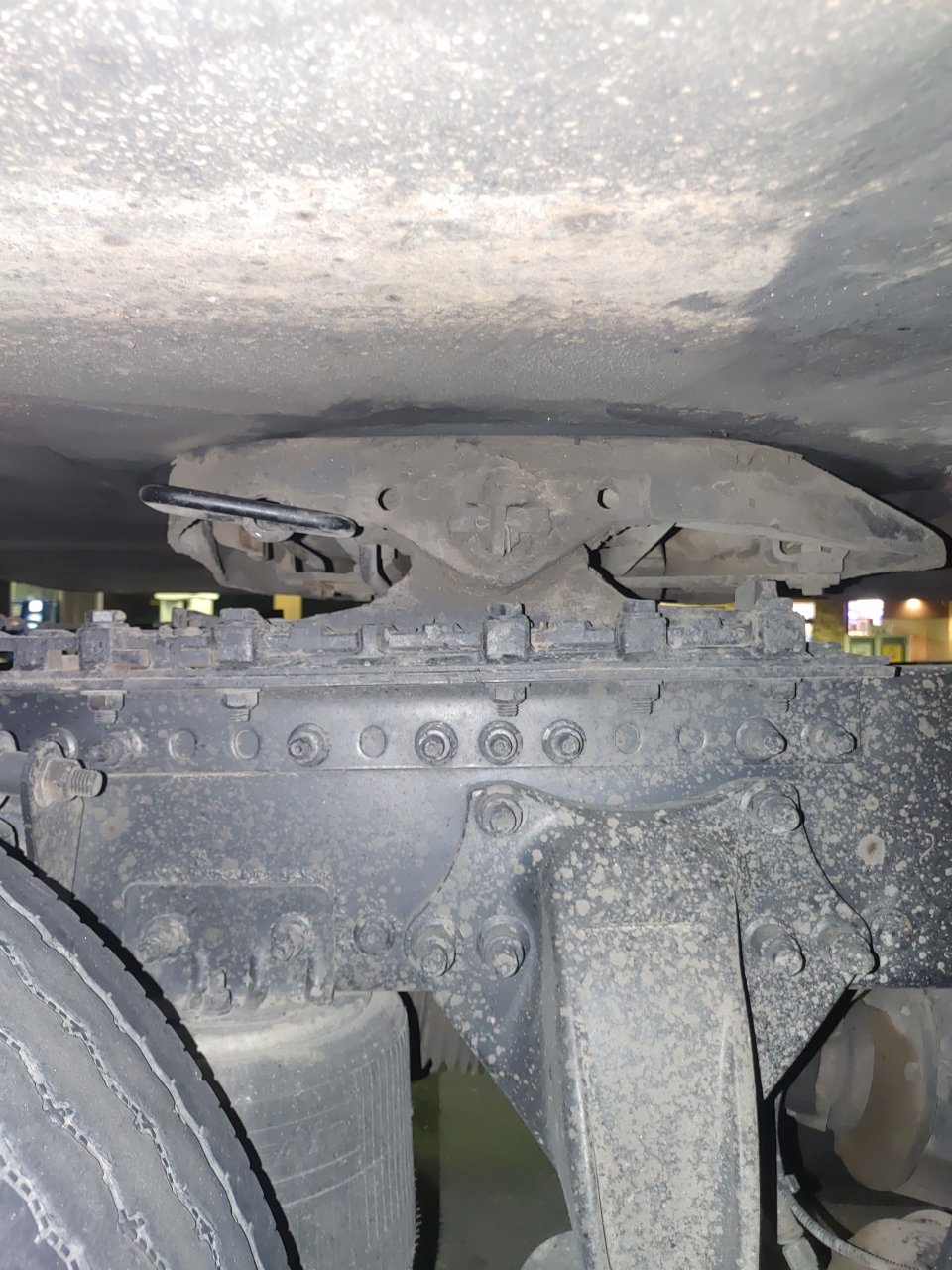

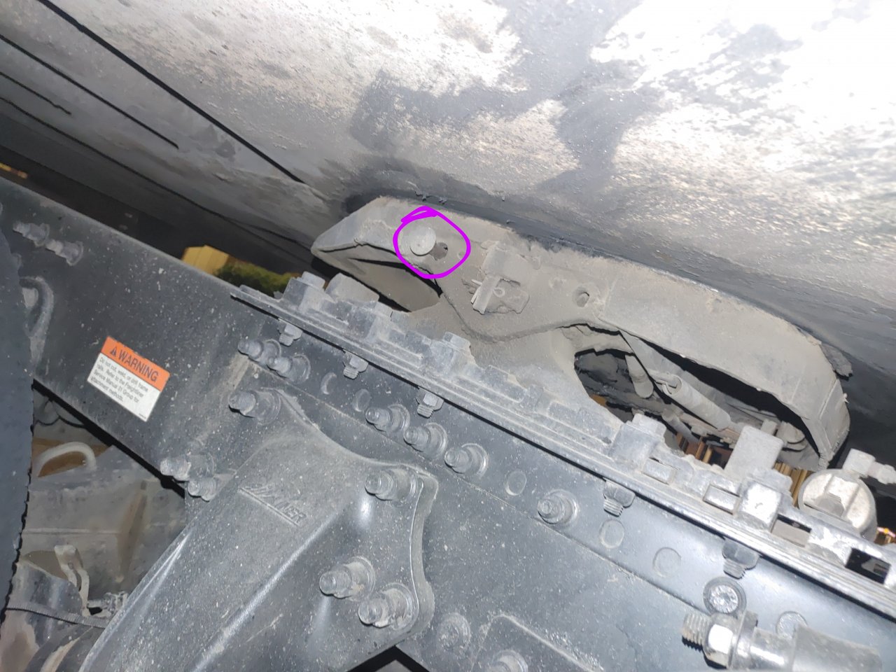

Is this normal??? Or am I freaking out for no reason??

    Message_1634971409214~2.jpg Message_1634971409214~2.jpg Message_1634971409214.jpg only 1 out of 4 pins and the one pin is half way out fifth wheel 20211022_234515.jpg

    That bolt is called a stop rod, and you're only supposed to have one. It is not structural. It's a long bolt with a spring around the middle section, and it threads into a square plastic nut that fits into a recessed area underneath. You should be able to press it inwards and get 1/4" of play, otherwise it should be adjusted.
    The empty holes are normal.

    Thats only for when your connected right? If ur not it will have alot more play correct?

    Aug 26, 2016
    While it's latched around a test kingpin or a trailer, you should have 1/4" play. I'm not sure about unhooked, since I haven't pushed it in that position. But I would think so, since you can see where the bolt contacts the wedge/locking jaw mechanism, and by pulling the release handle it creates a larger distance. You should be able to push it in as far as that spring's tension will allow, or I guess until the square nut falls out of its guide if that's possible.
