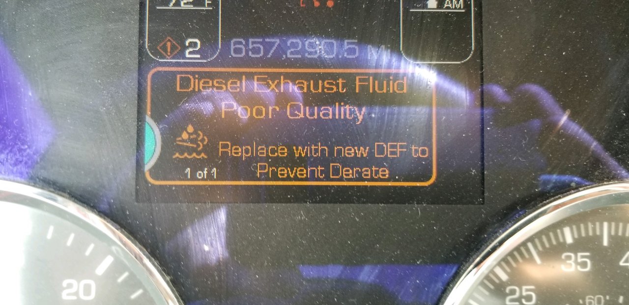

Is this what pops up when you get bad def fluid?

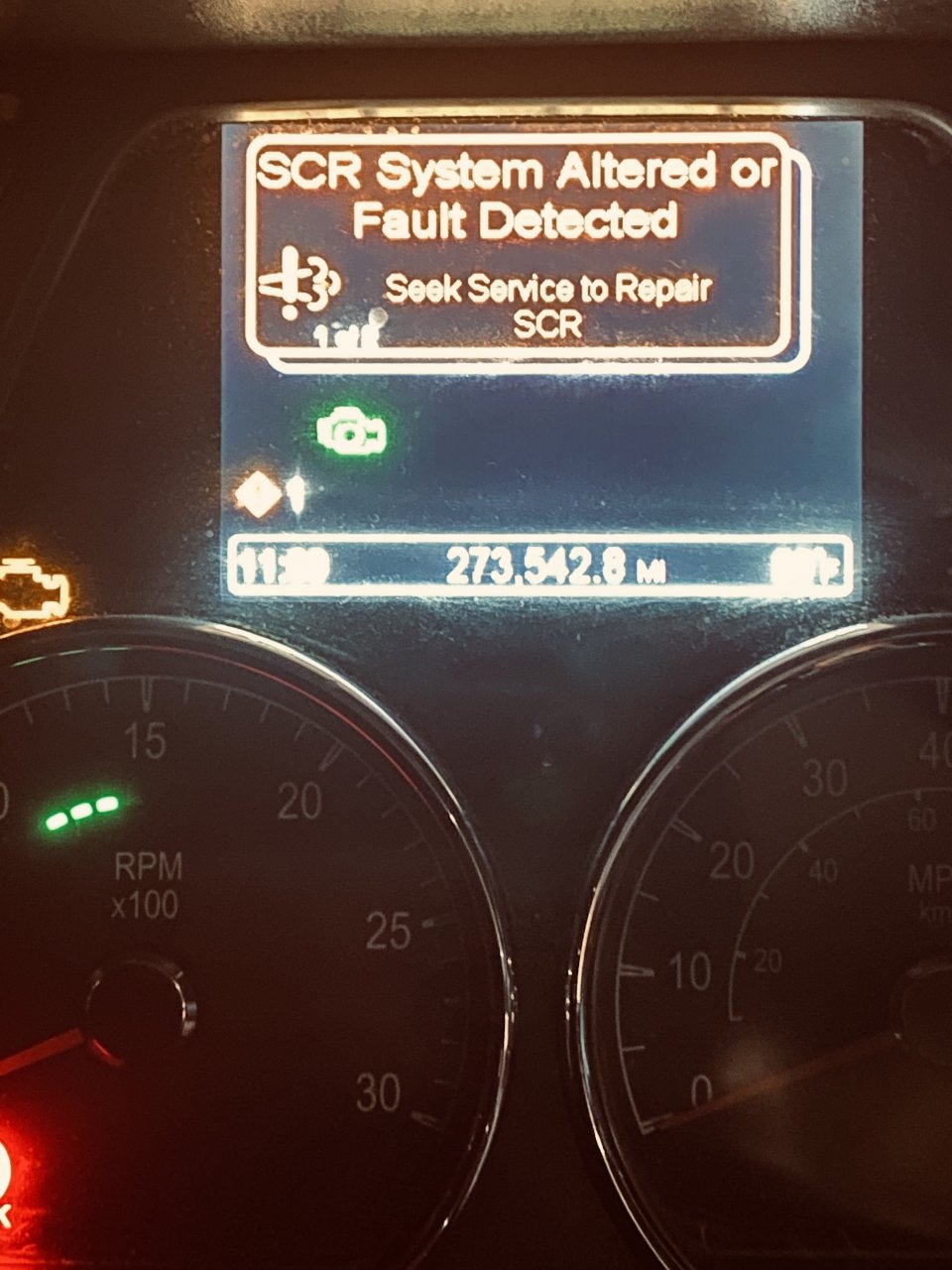

    Just had fueled up def at pilot and parked then this came on...is this simply meaning bad def fluid was put in??..

    Could have sensor problems , might not be the def......

    Maybe, but it could also be a number of other things causing it. Figure out which code it is in the diagnostic menu, then Google that code along with your truck make and model.

    Mine did this a few weeks ago. It was warning my engine would derate as well. I got it to Peterbilt in time. The diagnosis was a bad NOX sensor. Hope this helps.

    Without a code, all we can say is its just a general warning.

    It popped up immediately after filling my def tank...

    Ive had this message pop on. I kept driving and it went away after 30 miles. I had two engine codes show up in the computer that cleared the next day. Not saying you will be as lucky as me but thats just my experience. Mine did not show up after filling my def tank.
    There is a separate alarm (which I have also gotten) for bad DEF.

    Yeah, that bad DEF light was due to sensors for me. BUT, it happened right after adding DEF. So, obviously truck stop didn’t care but then again, they probably hear it 20 times per day.
    Id be tempted to run it, and see what happens.

  11. tiddlytanker
    tiddlytanker Light Load Member
    201
    577
    May 4, 2017
    Minot, ND
