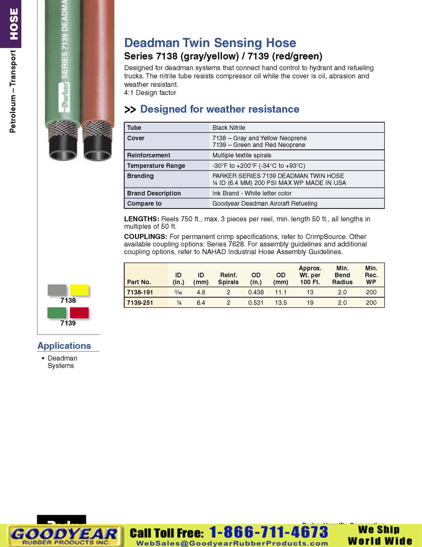

  9. Blackshack46
    Blackshack46 Road Train Member
    This image jogged my memory. Our air powered dead mans did have two hoses.
    So it was probably the deadman.
    homeskillet and taodnt Thank this.
  10. taodnt
    taodnt Light Load Member
    270
    410
    May 6, 2017
    North of Green Bay
    Thanks, that’s exactly what it looked like.
    A funny (or not so funny) aspect of what I saw was that the driver hooked up the ground wire, then hooked up the fueling hose and started fueling. It wasn’t until another fellow walked up and spoke with the driver for a couple of minutes that they both pulled these “dead man” hoses out and attached them to the plane. I am guessing those are supposed to be connected first?

    Well, I'll be dogged. They really DO make an air-powered deadman for refuelers. Thanks, blackshack!
