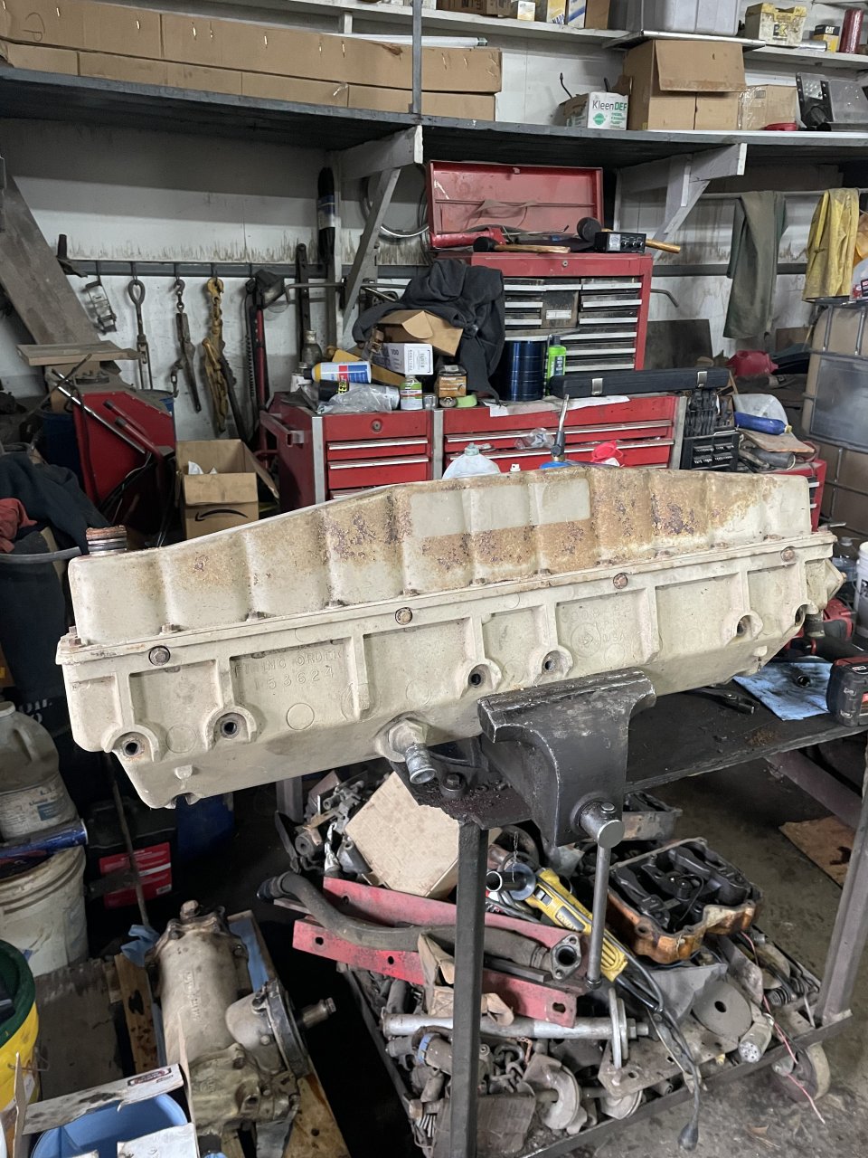

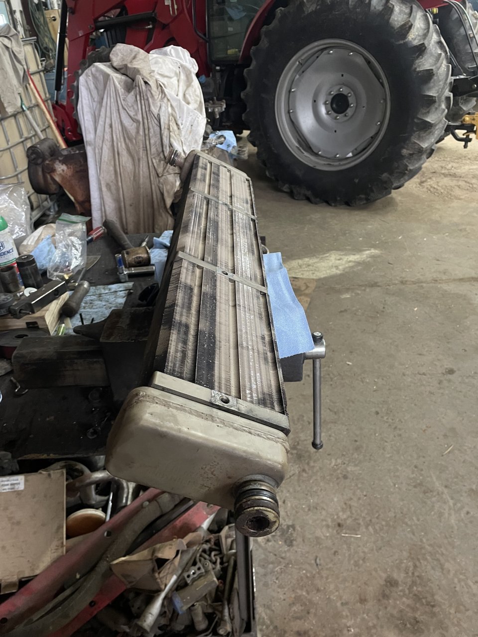

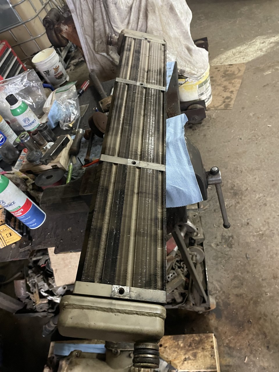

    What psi do y’all recommend testing this heat exchanger? Was thinking 5-10psi and soapy water. IMG_7732.jpeg IMG_7734.jpeg IMG_7735.jpeg
