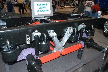

    If you get these tension bars you're golden. They're the red ones in the picture below I believe that's what they are called.
    The other types tend to move side to side when bushings are worn out and a lot of troopers spot the very easily. Which means your out of service. image.jpg

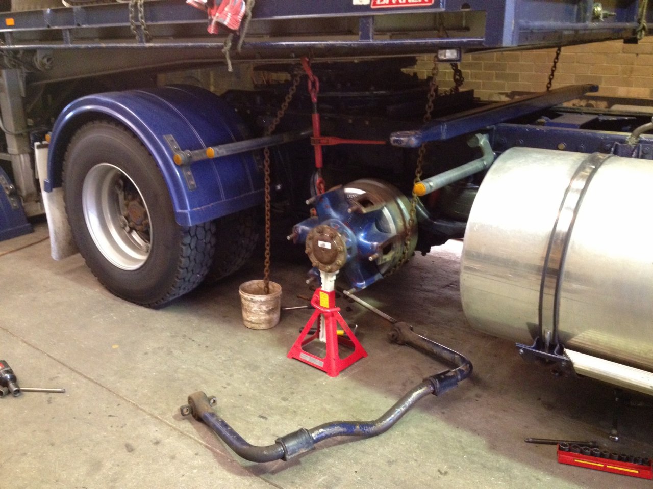

    The front dual pedestal sway bar has a kink in it to clear the power divider like you can see in the pic but the single pedestal bars are straight from memory

    They're torsion bars. But yeah, spot on. The AG400 causes the least amount of problems of the eight-bag setups.
    Converting to the 400 style is easy if anyone's interested. The hard part is forking over the dough to by them, that is if you're getting them new.

    That's a AG400 and his 95 model year doesn't have it unless someone converted it.
