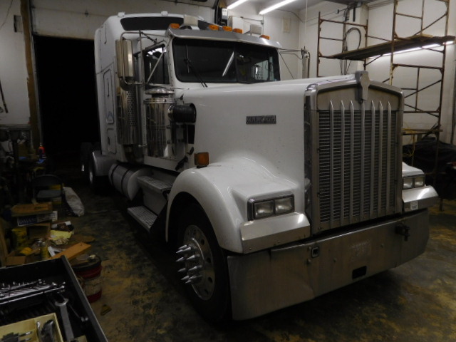

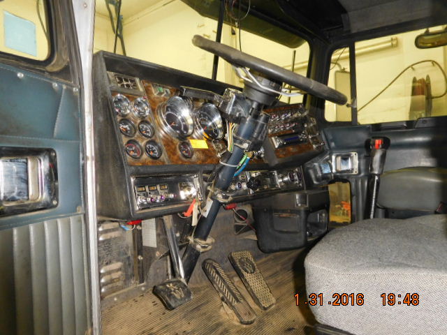

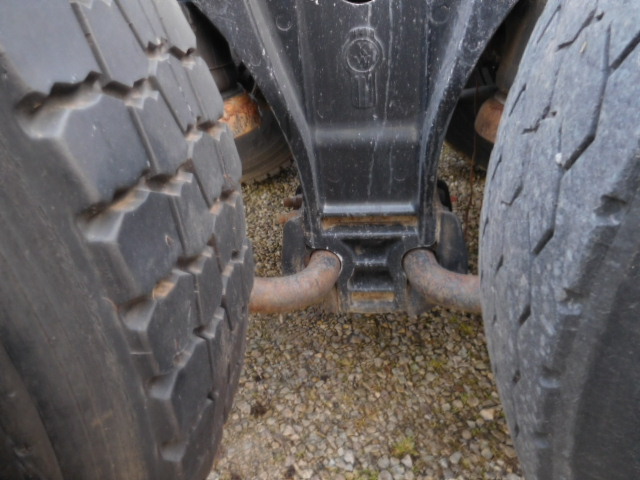

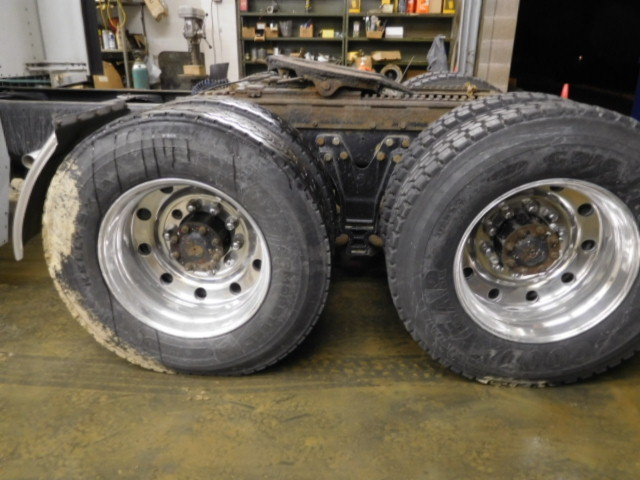

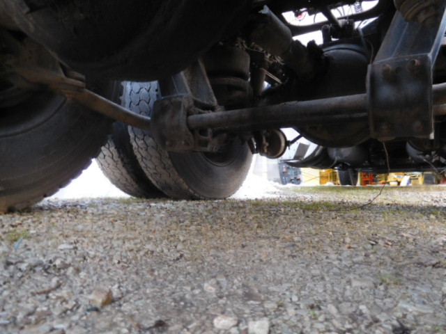

    Well guys here's ya'll a sneak peak at what I'm starting with.... Don't ya'll be making fun of it now doggonit.. lol :D It is a W900 L series which is what I prefered, Cummins big cam with a N14 air to air setup on it, 13 spd. Not sure what gears are in it yet.... But here a few pics of the suspension, if you can give me some insight I would sure appreciate it. Thanks. Gotta do a little fixing and a little cleaning but when I'm done it will be to my approval. Main thing is all them darn purple knobs and switch things somebody put all over dash!! Good grief.

    Definitely the AG100 there.
    Edit: Good grief. Someone tried making a Peterbilt out of that KW. What with all them purple switches and what not.

    On the Ag100....where the round "U" shaped torsion bars bend 90 and pass through the big brackets.....that's where the plastic (or nylon or polyethelene or whatever) bushings are and they like to wear out. If you get someone to rock the truck back and forth you can see how much play you have. It's almost a guarantee that they need doing. Not a real bad job although getting the bolts out might be tough if it's been a while.

    If the long bolts clamping the torsion bars are in an aluminum block and haven't been out in some time they can be aggravating to get out. Steel bolts, aluminum spacers, salt, and no Neverseize are not a good combination. I am sure you know that.Just a heads up. In May of 2013 somebody have a nice looking W9 60" flat top with a Cat for sale in your neck of the woods. It went off the Truckpaper but I don't know what became of it. I was set on buying a W9 with a Detroit so I passed. I was also wanting a southern truck. I did find one.
