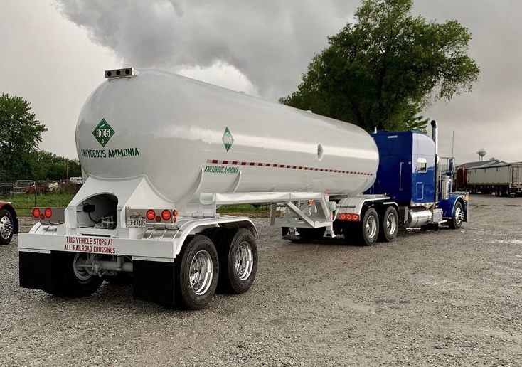

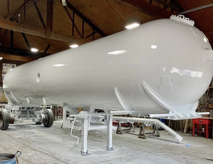

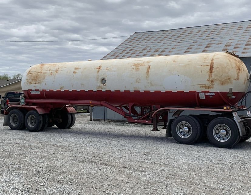

    This is a 1967 that a friend of mine rebuilt in his shop last year. He’s also done some late 70’s and early 80’s ones. He buys used air ride slider assemblies from wrecked trailers and rebuilds these into air ride trailers. New lights, new valves, rebuild the pump, get current tests done and you basically have a trailer that’s worth we’ll over double of what you paid for it.
