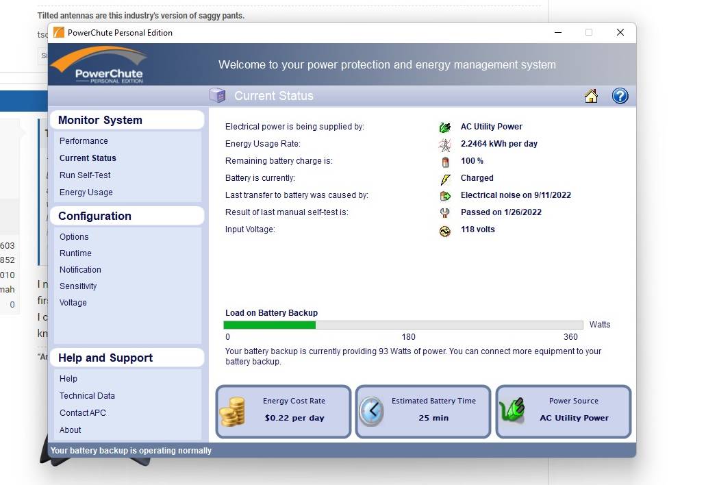

    As far as power goes. This is a screenshot from my UPS app that shows the load on my UPS. I have my desktop computer along with 2 monitors and my printer on it. Then I have my iPad running off it because I am watching a football game on it. I am not gaming I know.
