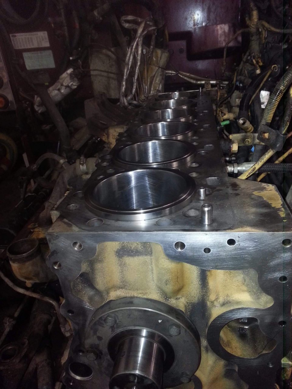

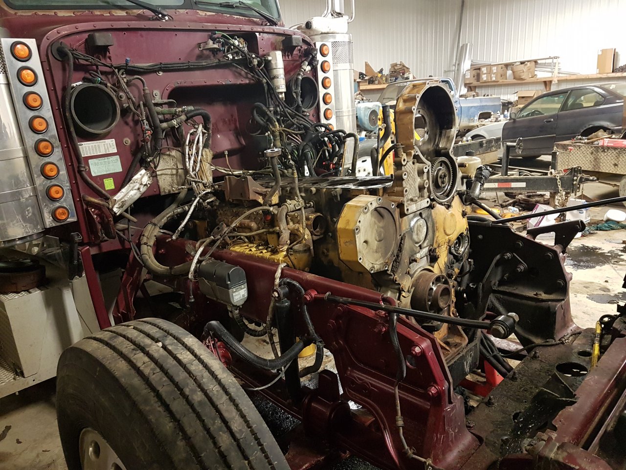

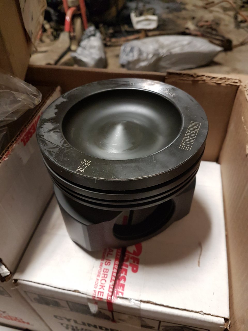

  10. dustinbrock
    dustinbrock Road Train Member
    1,308
    901
    Apr 19, 2012
    North Battleford, SK
    Here is my 2008 sdp right now. 3rd time I've opened it in 2 years and it's always been due to some stupid crap. This time I am doing absolutely everything! All wiring, every sensor, cam, injectors etc etc.... also removing a bunch of junk as well, just extra weight!
    SAR Thanks this.
  11. Superhauler
    Superhauler TEACHER OF MEN
    12,209
    100,730
    Jan 30, 2010
    keep stroking.
    Are you switching heads from the spd to the early acert head? And are them the low comp pistons? If not, I would.
