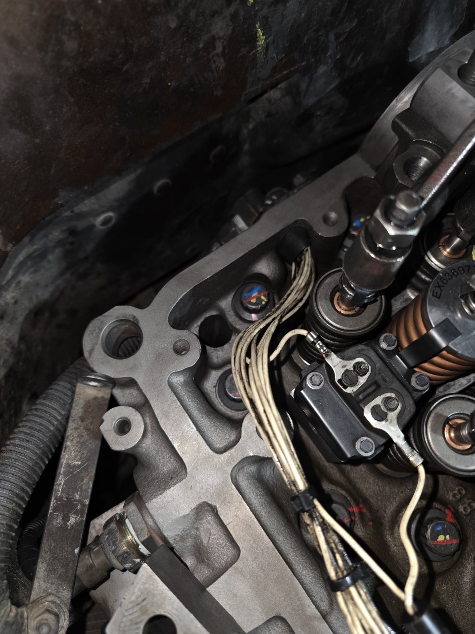

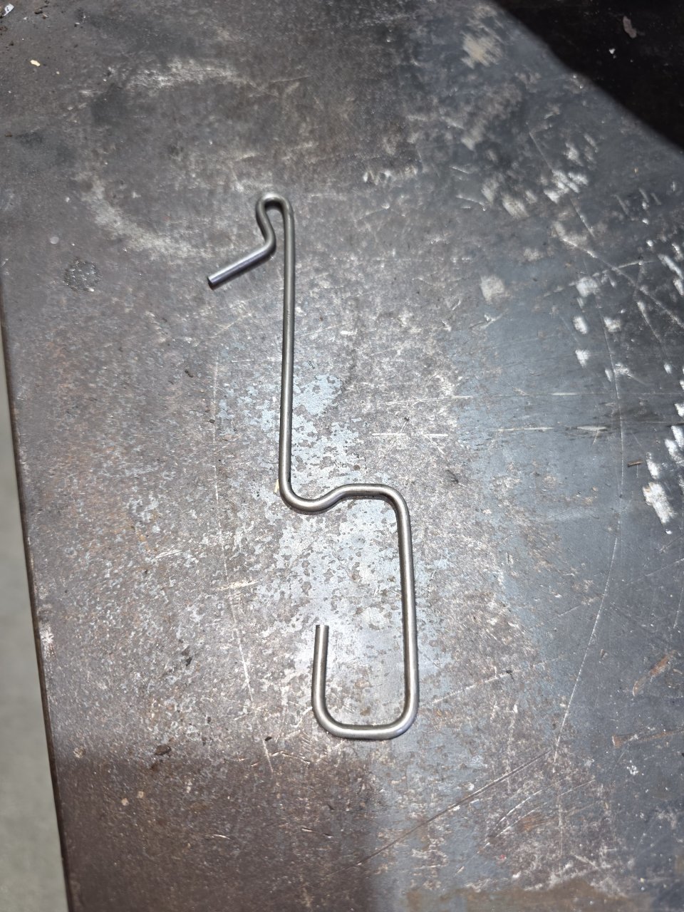

    I have it assembled. I questioned the torque on one of the head bolts because it kept turning. It did not neck the bolt down. I pulled and installed a new bolt and washer. The new bolt took the torque well. I do have another question about a wire that the Detroit mechanic told me retained the injector harness. I cant figure out the orientation. Does it go into the hole in the head or bolt to the Jake head on the rear? 20260923_175440.jpg 20260923_174943.jpg

    The top part on the picture goes down into the hole. The bottom end in the pic will stand up, and hold thd harness.
