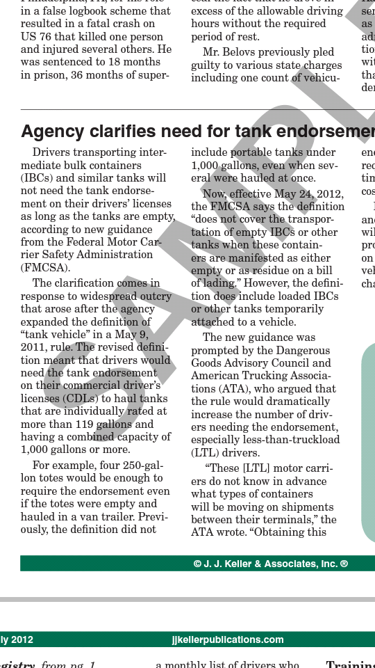

    .....Which is 119 gallons for a portable tank, IIRC.

    Correct, with an aggregate of 1000 gallons, I believe. So just one or two won't require the endorsement.

    Correct. Most typical "IBC" totes have a capacity of 275 gallons, so you'd need 4 full ones of those before the endorsement is technically required.

    Yeah, the rules used to be that a tank over a thousand pounds required the tank endorsement. Smaller tanks, like having a 500 gallon water tank on a trailer to spray something out wouldn't require the endorsement.
    I've heard that there were companies that went and separated tanks into multiple large tanks, say 900 gallons each, to avoid needing the endorsement. Seems stupid to me, but whatever. So as a result of that, or perhaps just because they felt the totes should require the endorsement, they changed the rules. It still requires an aggregate of 1000 gallons, but now that can be in bulk containers rather than just one large tank.

    55 gallondrums do not fall into the N endorsement. The invidual tanks must be 119 gallons by themselves and more than 1000 gallons as a whole before the N endorsement comes out.
