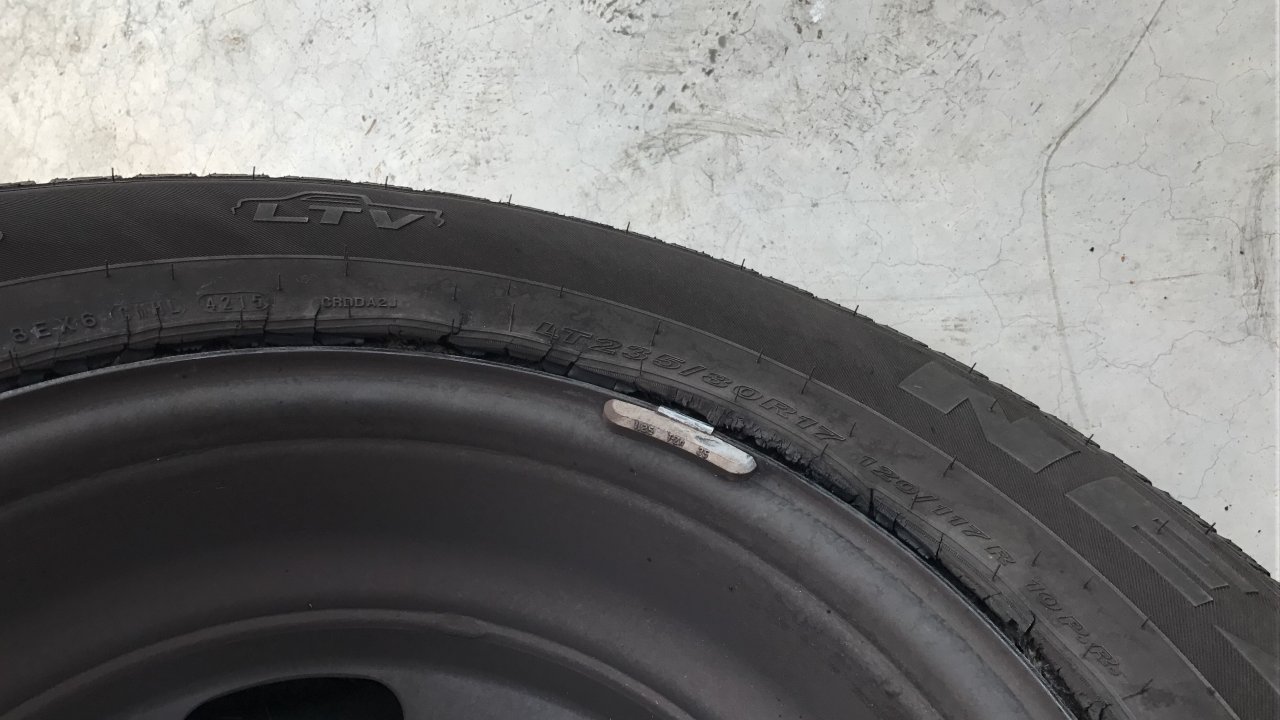

    Hope you upgrade your tires to. This was a truck with less than 40k on it. Still had plenty of life in IMG_1433.JPG the tread then this happened
