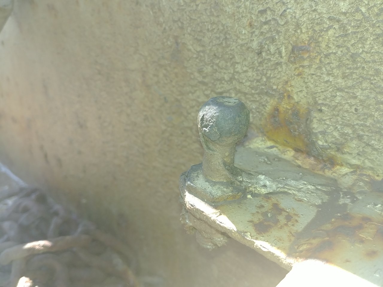

    Like this???
    Sorry bad lighting.
