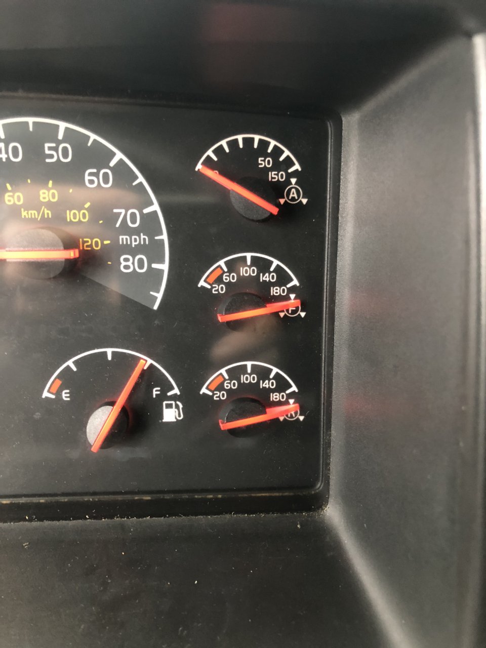

    F640B9F2-B1FA-44EF-A068-D97E1337CCDF.jpeg I woke up today to this. Is this the cluster issue or the sensor is short???

    Open your tanks drain and see. Stand back though 200 PSI will cut your fingers off.

    If truck was idling all night could be faulty governor. If you just turned ignition on probably sensors circuit or dash. You can run dash test in driver menu Sweep Instruments to check

    This time it happened when it was idling over night and it’s first time they both did it at the same time. I’ve seen bottom gauge do this before while I was driving on a highway and usually on a bumpy road like in Indiana. After a couple engine start ups upper air gauge went to normal operation, but bottom one still was doing the same. So yesterday while waiting for loading I disconnect battery’s for like an hour, just after reconnecting them and on a start up it did reset the bottom one

    Did you run instrument panel diagnostic test?
