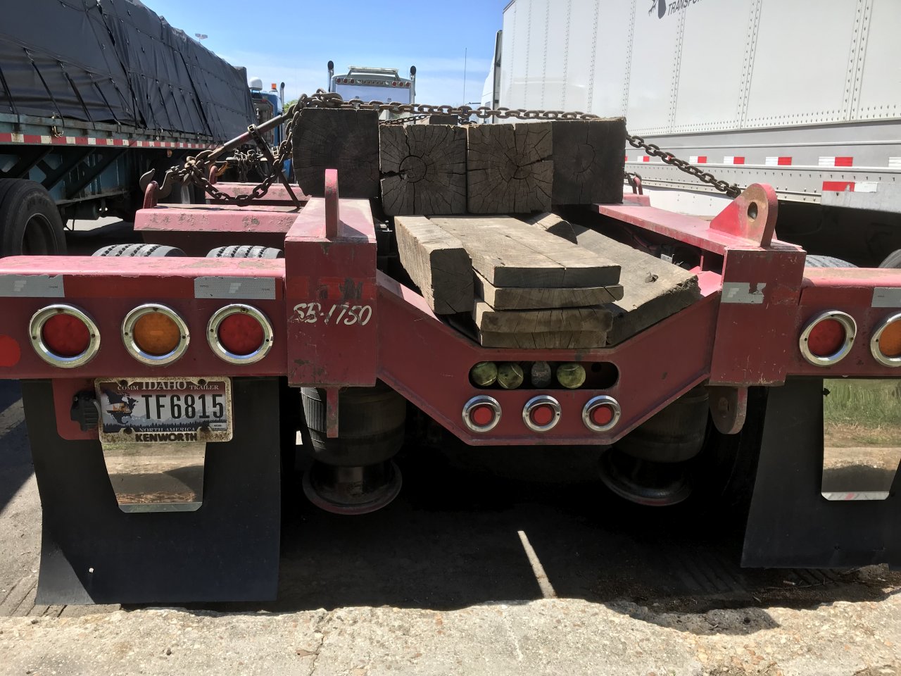

    F2FF047B-57C6-4A2D-B9F4-AFC63ED32CFC.jpeg Hoses came apart twice thru the years.
    Definitely an oh crap feeling.
    I’ll give mine a good cleaning bout once a year.
    Lightly wire brush male ends, graphite spray in female ends.
    Also, cut a “X” in old tennis ball too cover when not using. Winter spray kills ‘em.
    I do the same on neck if I’m in the slop.
