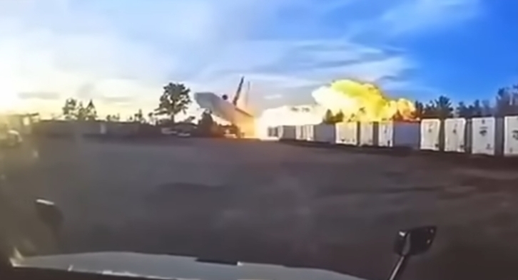

    his tractor was parked and it looked like it was daybreak. Probably either beginning or ending his shift
    The_vett Thanks this.
  3. Kenworth6969
    2,980
    9,342
    Jul 3, 2020
    If bro was on the other side of the yard he would have been cooked.
    Goes to show that truly anything can happen at any moment.

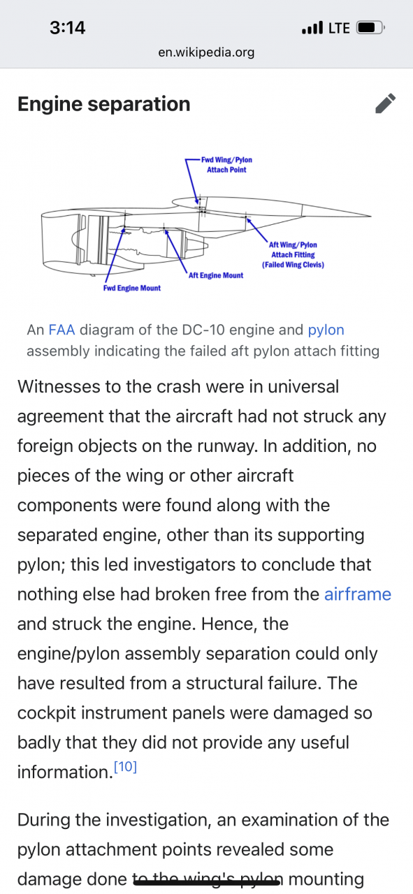

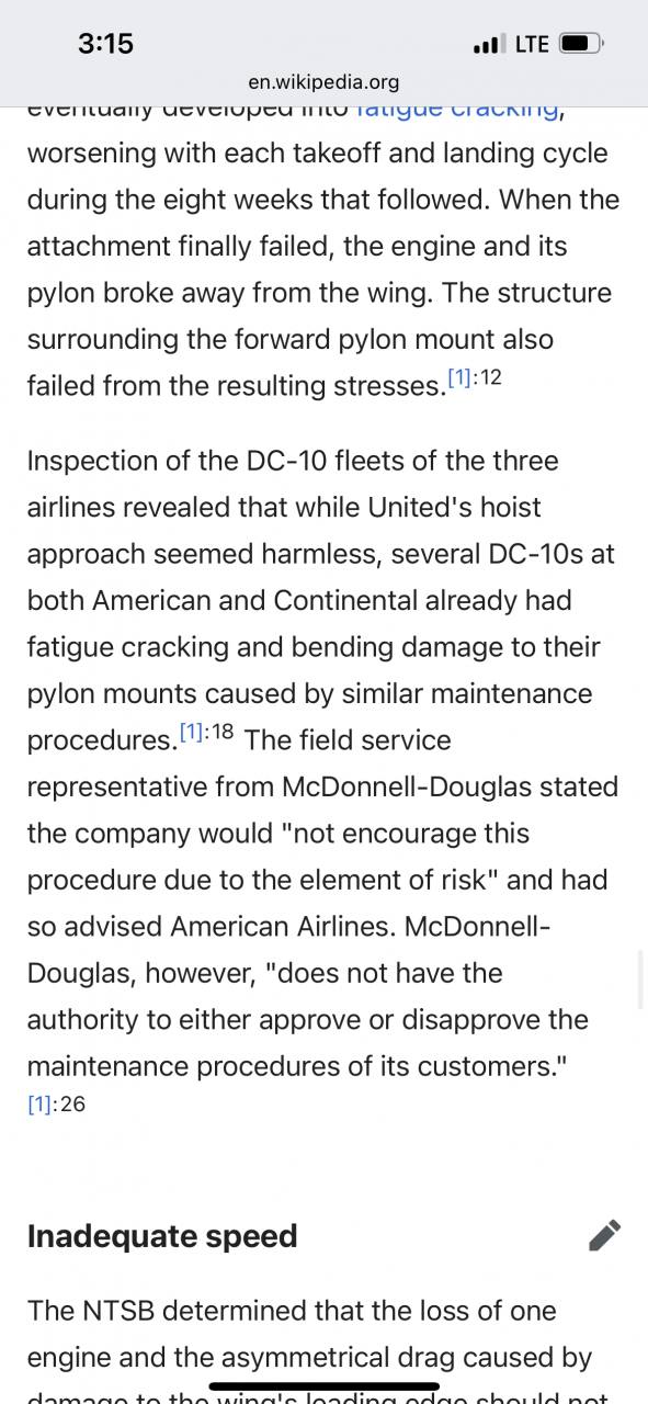

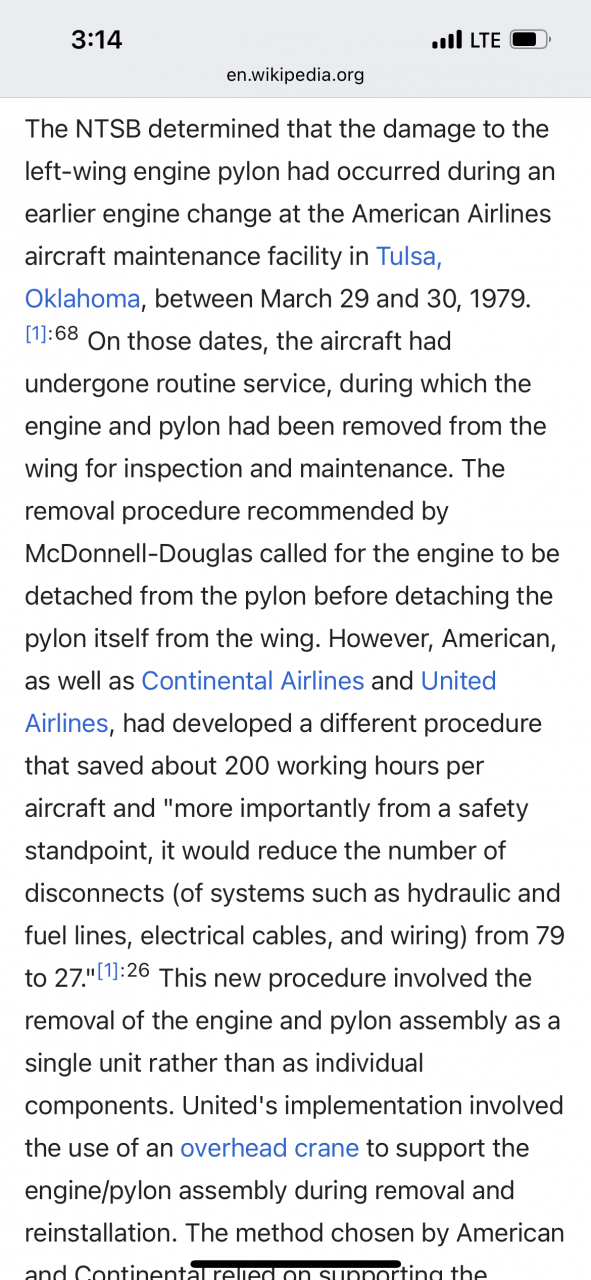

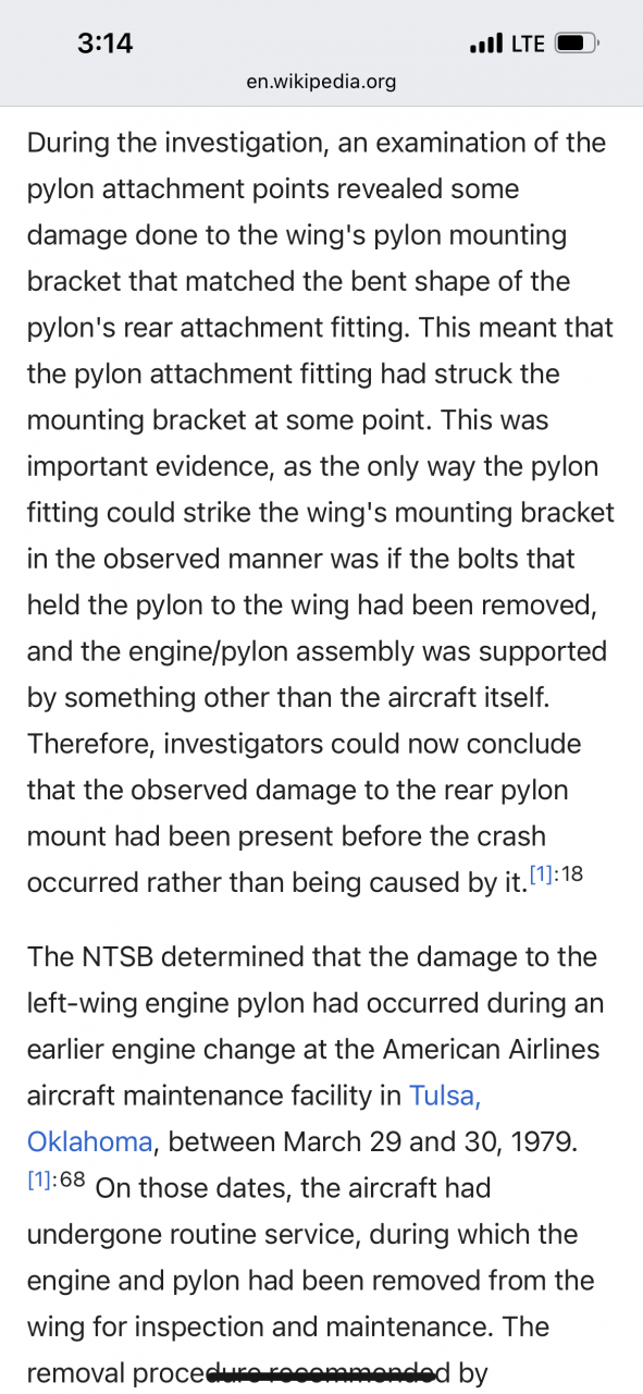

    Was that the one where they mounted the engine to the pylon with a forklift and damaged the pins and pylon?
    Saw something like that on Mayday, can’t remember if it was a md11
  9. mjd4277
    mjd4277 Road Train Member
    14,880
    46,056
    Oct 4, 2015
    Fitchburg,MA
    Yup.
    In the middle of the procedure the forklift had been powered down due to a shift change.
