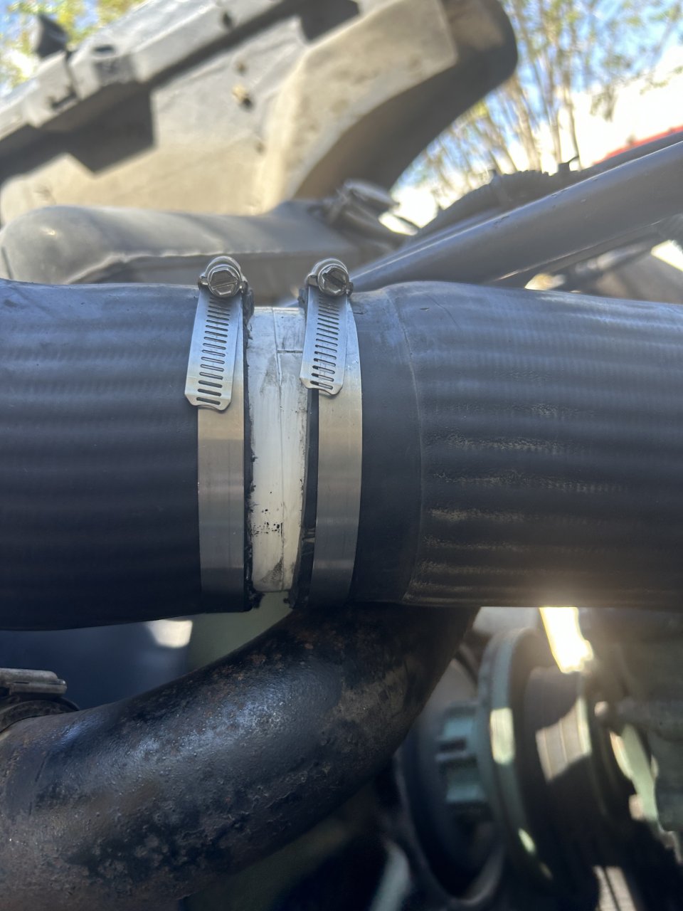

    B11C51BB-B6C6-4654-B926-F42B5C5339D6.jpeg 4” pvc coupler and 2 hose clamps. Home Depot $18. Should last another 23 years.

    I wouldn’t trust those clamps.
    Have you ever seen a joint blow apart under pressure? It’s impressive.

    Well my experiment already failed. Big Boom!! Glad it wasn’t a tire or the turbo. Out it back together for now. Why won’t something similar to the hit side work on the cold side? More pressure on the cold side? More resistance maybe from the valves/pistons than just the CAC cooler?? Seems if the red silicone hoses will hold without blowing, any thick plastic or thin steel or aluminum would be plenty strong without cracking. Just wondering. I obviously don’t know. I think if I go ad better clamps it would work fine. That coupler is thick.

    4 inch irrigation pipe can work if you can bead-roll the ends.
    Whoever owned that truck before you replaced the aluminized steel tubing with rubber hose and even double fabric reinforced hose will stretch and pop.

    No. That’s the original hose it was built with. Just like most Trucks. It’s on the cold intake side, not the hot turbo side.
