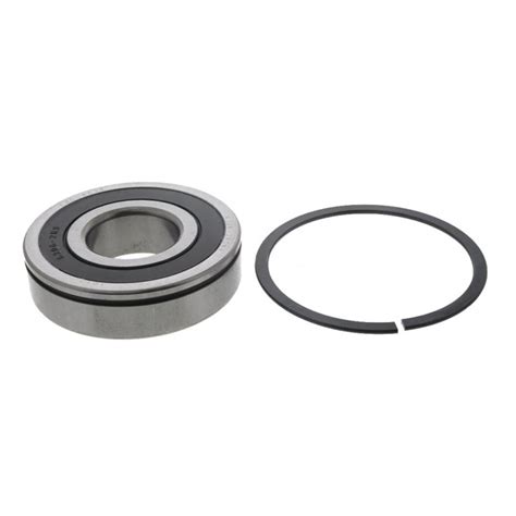

  7. Star Rider
    Star Rider Road Train Member
    1,464
    12,012
    Sep 23, 2019
    Michigan
    Did your pilot bearing in the flywheel have a snap ring on it? The snap ring is only used with a Mack transmission. When using a Fuller transmission it must be removed and the pilot bearing driven the rest of the way in.
