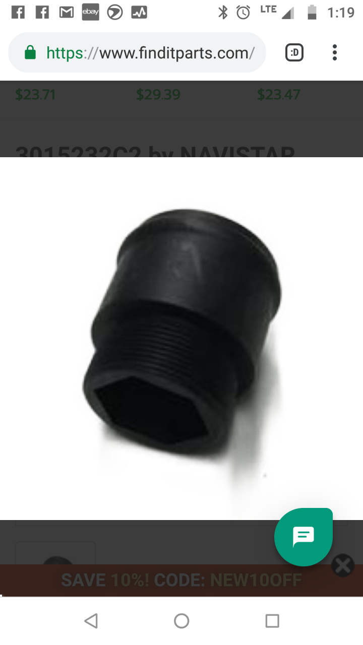

    I was wondering if any of you have replaced one. I've replaced rubber tube connecting upper filler neck with lower filler neck that is fixed into engine block.
    I cleaned all of the oil residue and ran it for few thousand miles and it's apparent that lower filler neck is leaky, don't know if it is cracked or there is an o-ring or thread sealer that failed. I ordered a new one anyway as it was only $21. Is there any special removal tool required for this replacement job? Any advise is much appreciated. See picture for reference.

    That is very common leak point. I have never personally changed one, but our shop has, and I'm pretty sure it just threads out. There is nothing special in the manual about it, just "remove" it, LOL. It is only plastic, so be careful. Start with some channel locks, but try not to crack it. If it won't turn with them, you might have to try something like a filter strap wrench. It says to use Loctite 545 all the way around on the first 3 threads and tighten to 26 ft lbs.

    That's what I'm afraid of, cracking it since it is plastic I thought there's a removal tool of some sort.
    Thanks for heads up Heavyd, I can take it from here

    I know there is a large inverted hex in there, but I have not seen a tool for that. You would need the biggest allen key I have ever seen for that, LOL!

    That's what I actually thought it's needed, giant hex but I was going to wait until I get the part in my hands to see if I could match anything to it.
    It be funny if it would fell inside the crankcase, lol
