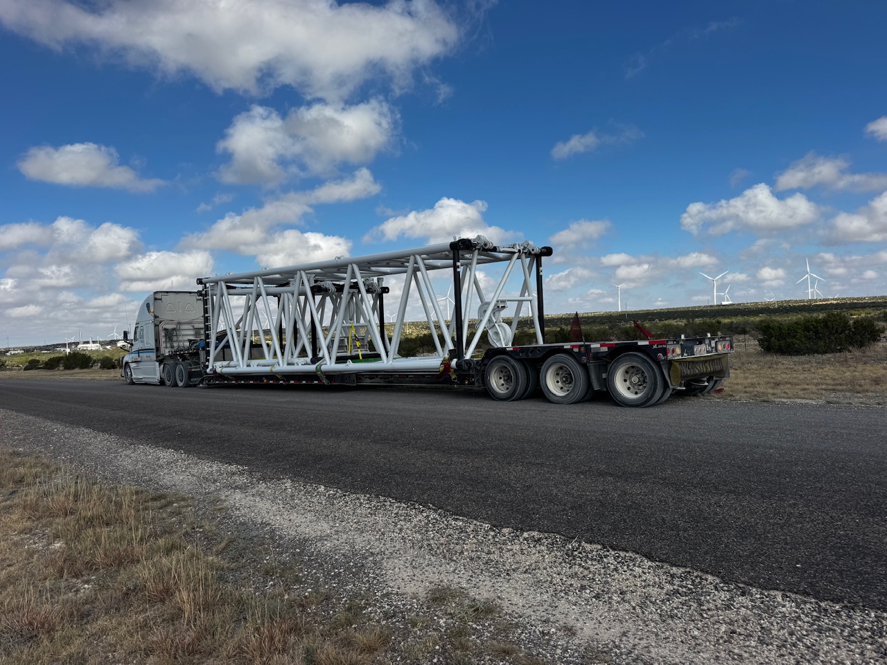

    In this case it didn’t. But the longer the load, all the weight goes on my drives. This load in the picture below was about 36k and my drives were at 38k. I had stretched 14ft for total deck of 43ft.

    A couple lengths of used conveyor belt might help keeping the drives digging holes. Don't need a lot, just where the trailer starts to lift and then cams over. Toss it on the deck when hooked away you go.

    Also, it’s probably my fifth wheel height. Looking at the picture shows how the trailer is really low in the front. I have been extremely busy and financially tight to address it. That is take time off from loads and go to just any shop. Trying to get to my company’s mechanics. Been ripped off or no service dealing with shops on the road.
