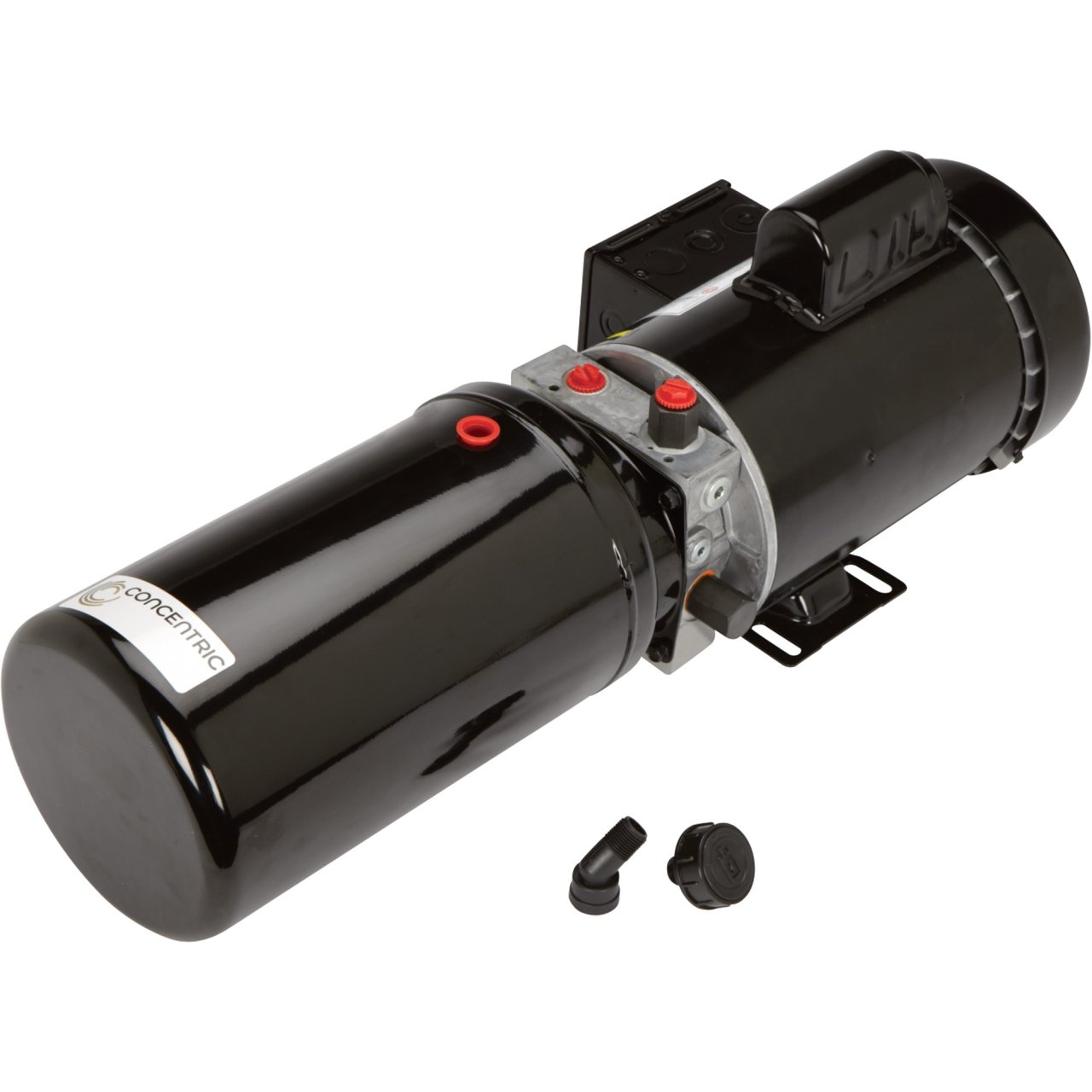

    I agree with all this, as far as the hydraulic system goes how about the electric powered unit Keen uses? That seems like a decent idea.
    SAR and Dominick253 Thank this.

  9. johndeere4020
    8,522
    119,296
    Jan 1, 2010
    It's a pump like this,
    It would be slower than a wet line or pony motor but a lot lighter and less problematic.
    wore out, SAR, MartinFromBC and 3 others Thank this.

  11. Mack427
    Mack427 Medium Load Member
    323
    93
    Jan 22, 2009
    had one of keens old talbert drop sides with one it runs the neck as fast has a wet line or gas motor there are larger than what you have there the elec motor is about the size of a big truck starter
