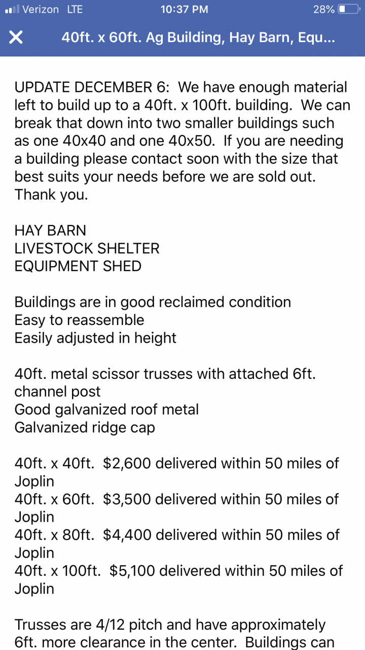

    I know you said Arizona, but on FB marketplace here, there was a guy dismantling and selling chicken barns for a steal - in 10’ sections -
    You load, or he delivered - make for very cheap utility sheds.
