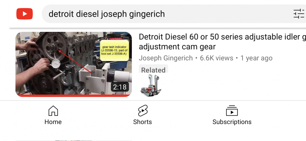

  13. Rideandrepair
    17,337
    56,256
    Aug 8, 2015
    4C7BBC63-C79A-45A0-8EA6-0B17068870BA.png If you want to do it yourself, and need info. Check this guy out on YouTube. He’s good.
