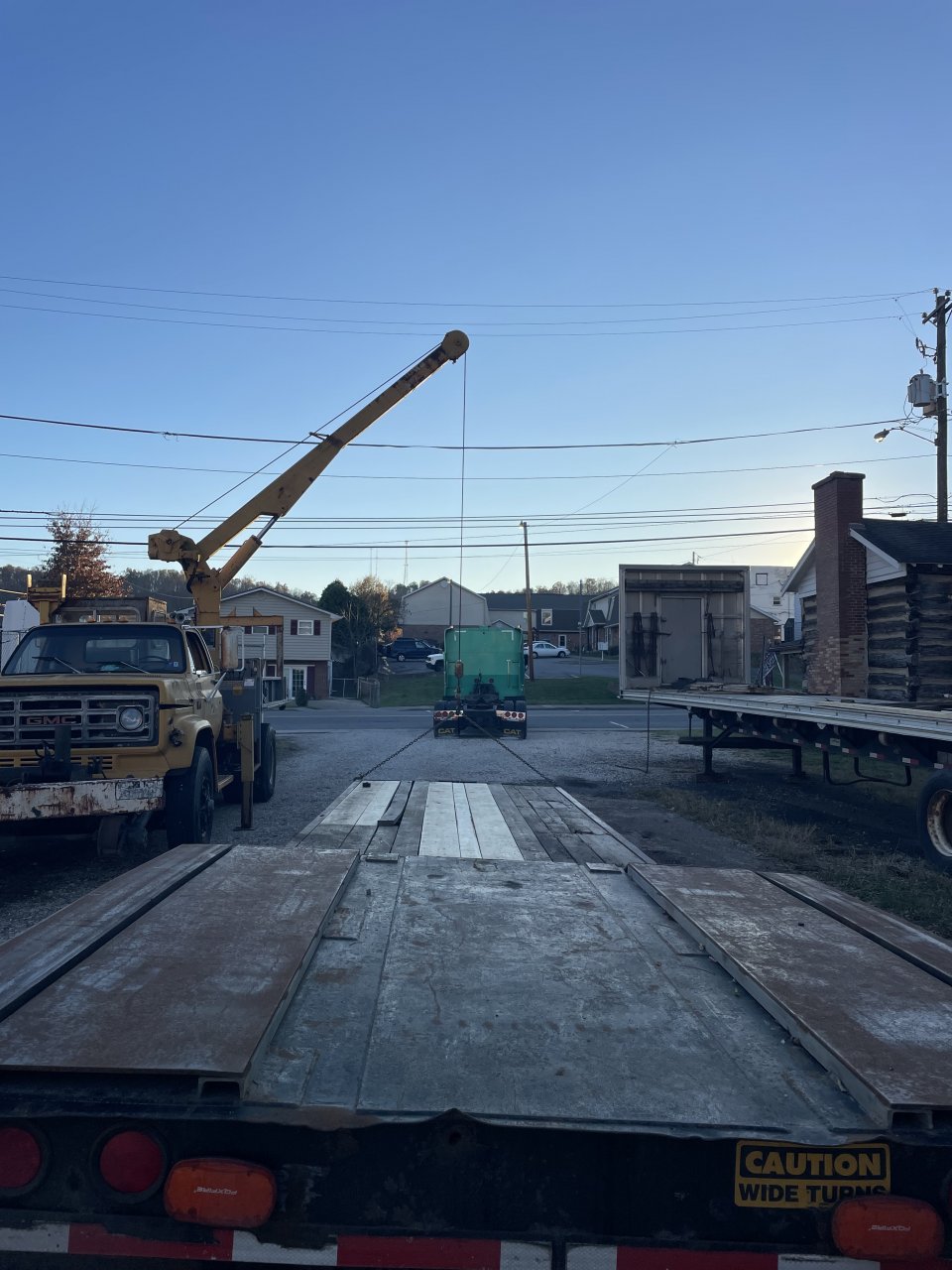

    My boom truck picks a little over 10,000. The winch will pick 7,000 before needing to double block the winch cable. The winch will pick the rear of the 2004 green Peterbilt in the foreground no issue.
    My advice is a SkyTrak with about 8,000 lbs of lift capabilities.
    Or…. Jack the rear axle up and chain it to the frame, then put a spacer between the the bottom of the frame and top of the axle housing on the front drive axle. Basically carry the rear drive axle….
    Oxbow and SwiftSecret Thank this.

  11. OLDSKOOLERnWV
    18,834
    284,003
    Picked this Pete up the other night with my 5th wheel wrecker, front drive axle brakes on the left side were froze to the drum (broke down last Thanksgiving ) I was able to hit the brake shoes directly on the side and they broke loose, just a little info you might try as well….
    Oxbow, Deezl Smoke and SwiftSecret Thank this.
