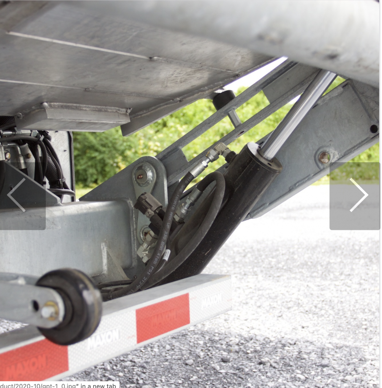

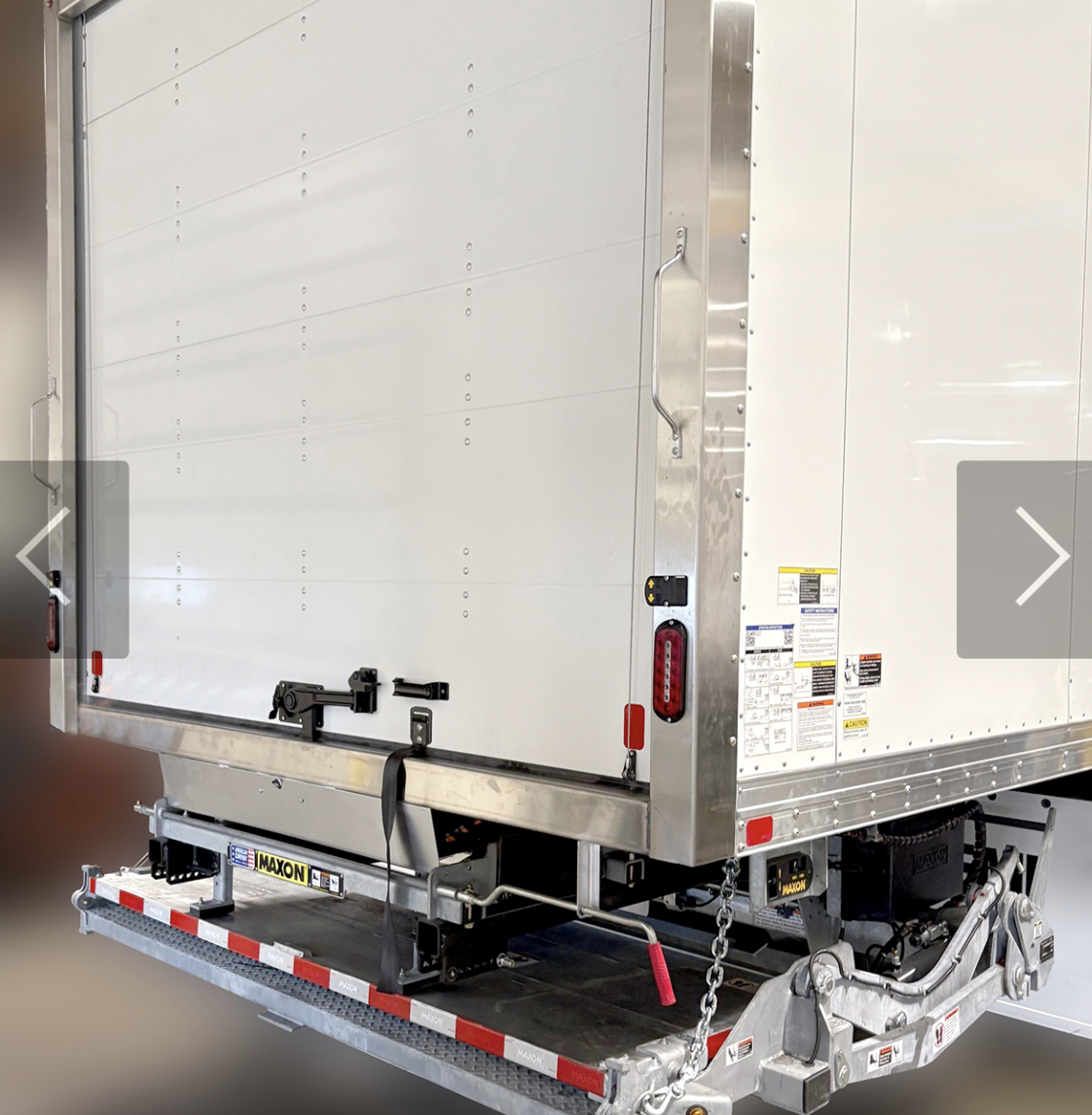

    I have not used every Maxon model? What one you talking about.
    Maxon manuals are about useless. Sometimes the actual locking mechanism is hard to find, but you can't have a situation where a hydraulic hose or seal fails and liftgate falls to the road
    The Maxon with chains

    And Maxon with hydraulic lock.
    : Screenshot 2026-03-01 at 12.20.44 PM.png

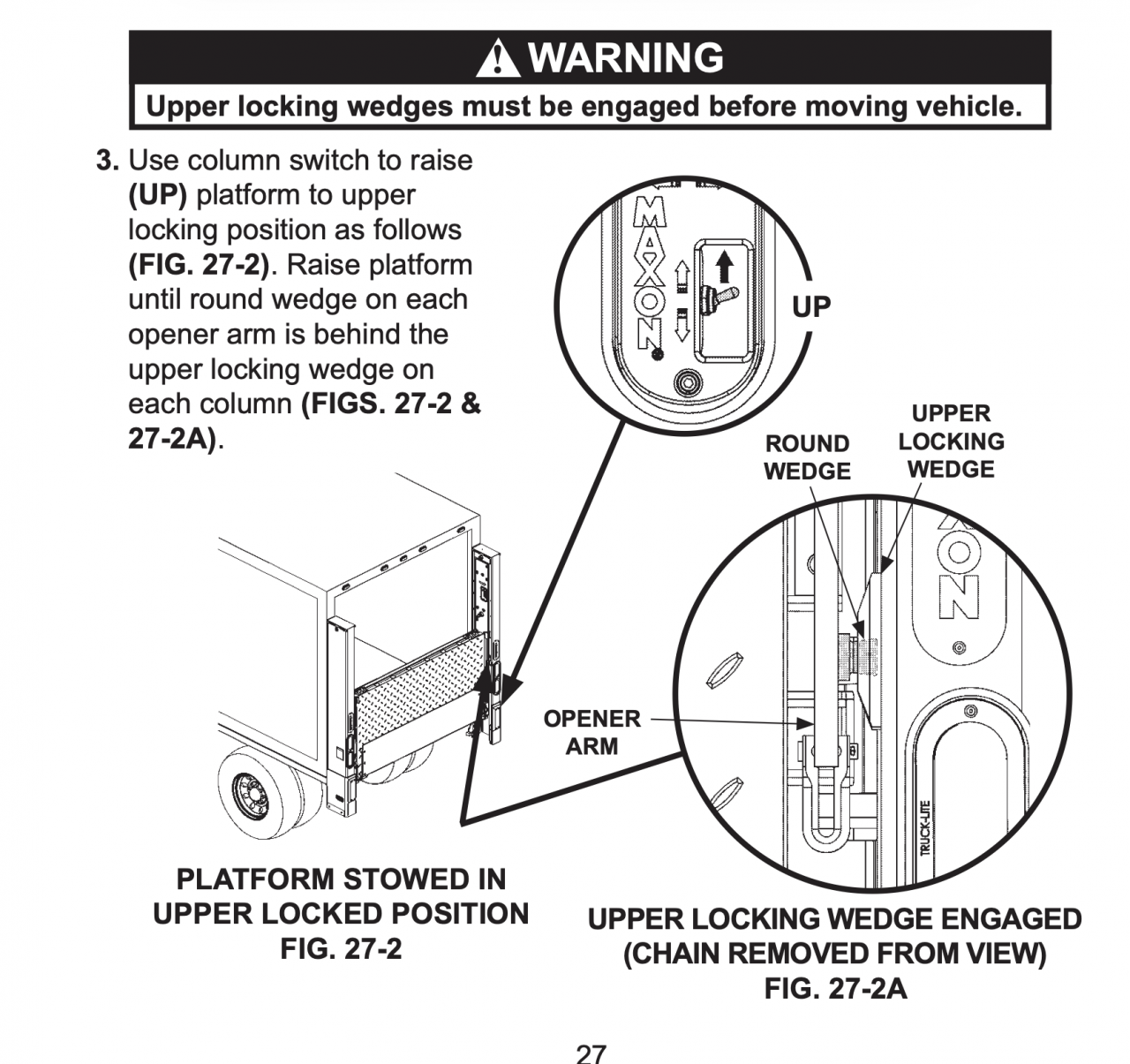

    Maxon says there are locks. They advertise there are automatic locks. It is in the manual: https://www.maxonlift.com/products/columnlift/bmr upload_2026-3-2_11-59-45.png
    Mega Express Thanks this.

    I have used those lifts before and you can hear the locks
    One of the most common failures of these lifts it the position switch that allows these lift locks to retract fails. The pump will run, the hydraulics will energize, but the lift will not move. It will be stuck on the locks that will not retract because of the position switch.
