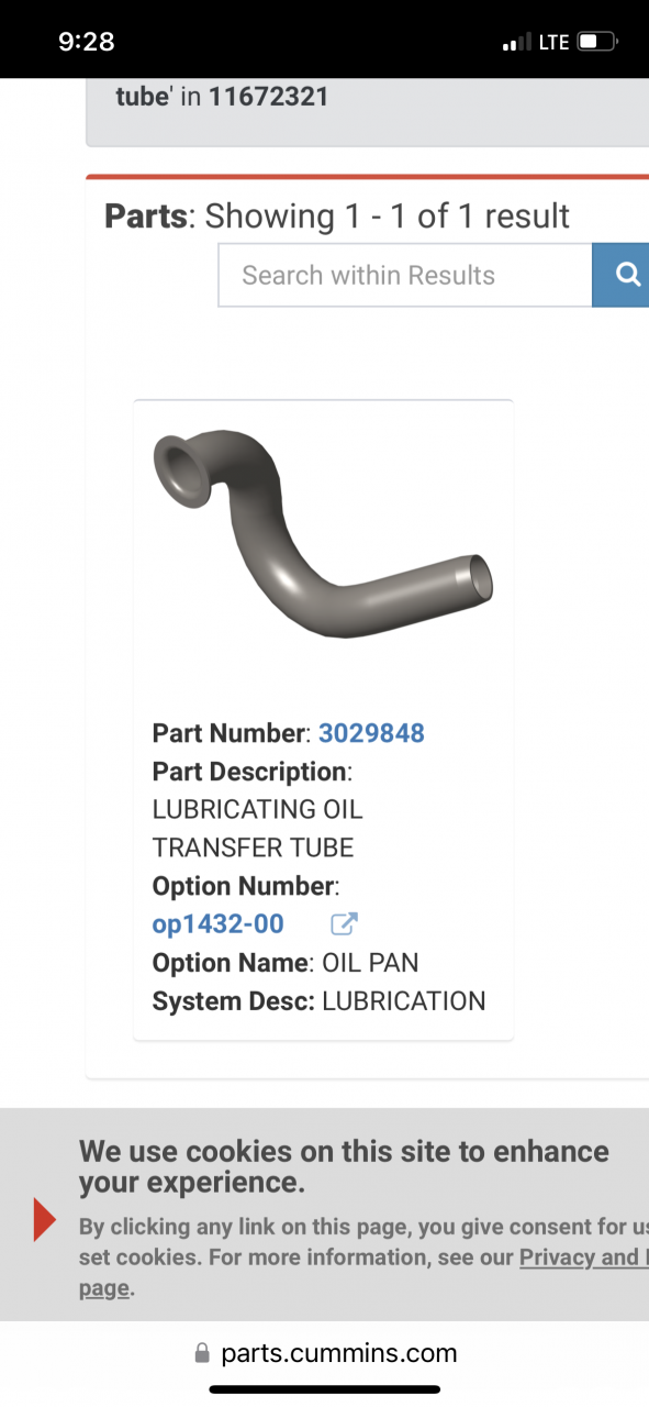

    I don’t like the looks of my rusty and decayed turbo return line and was looking for a Cummins part number? Same deal with the oil transfer tube, between the oil pump and pan. Not sure if my transfer tube is the 3029848 but that part number for the tube looks the same but doesn’t have the flanges on each end.

    Can you register your engines serial number on Cummins Quick Serve?

    Ok, I got the transfer tube but no results for turbo drain/return oil line.

    This is what they call for on a 2026 CPL. Screenshot_20250119_201114_Chrome.jpg
