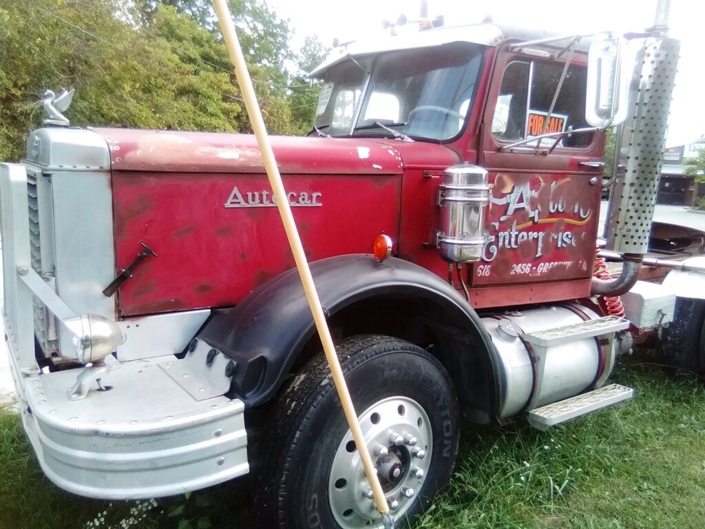

    Im trying to figure out whats exactly going on with the engine in this newly acquired truck of mine. Engine runs great and has 10K on overhaul but is severely under powered. I was going to replace with a BC400 or a B model CAT but this engine runs so well that im hesitant till it blows. I cant really get anyone (even Cummins) to tell me exactly what i have here. I do know it is a NHC250, but the turbo throws me off. Ive had some say its an add on. Ive had some say its a 270 or 290. Some say it does or doesnt have cooler nozzles. If I can make this engine pull a 48' equipment trailer loaded with no more than 30K#'s than ill keep it for a while. But the way it is, it is almost unbearable. What can be done to this engine to make it more powerful without sacrificing too much reliability? Thanks.

    A lot of things can change in over 45 years. Please post a picture of the fuel pump plus some of the right side above the oil pan.
    Look at the normal low power items like air filter and such. Then connect a hose to the side of the fuel solenoid. Hang a pressure on the mirror. What does it read while driving under load?

    Good advice,like he says,check simple stuff first. All filters. Should run your rack,and make sure all that's correct. Check the snap pressure at the solenoid,that will tell a lot about the fuel system settings,and condition. If that's the original tag,turbo is an add on. Does the truck have a pyrometer or a boost gauge? As far as getting a little more power,it can be done fairly simple with a fuel button change,or open the throttle shaft a little,if your turbo is working and making boost. But you need to know that everything else is correct,before doing these things.
