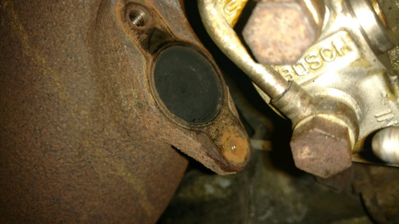

Just a couple of wrenches. One for the fuel line and one for the doser. You don't remove the coolant lines or the assembly.

this was before the truck was purchased, and I want to keep this from happening again. Seems as though the coolant lines are not taken off for it’s cleaning and only injector was.
anyway to clean the injector while it’s off?
you dont need to remove entire block. you need to remove only injectorLoneRanger Thanks this.
You could clean it with diesel and a rag I suppose, but I've always just replaced them. And I don't mess with them at all until I get the code.LoneRanger Thanks this.
just trying to know things in advance so I don’t get stranded on side of road. Thanks for answering.
