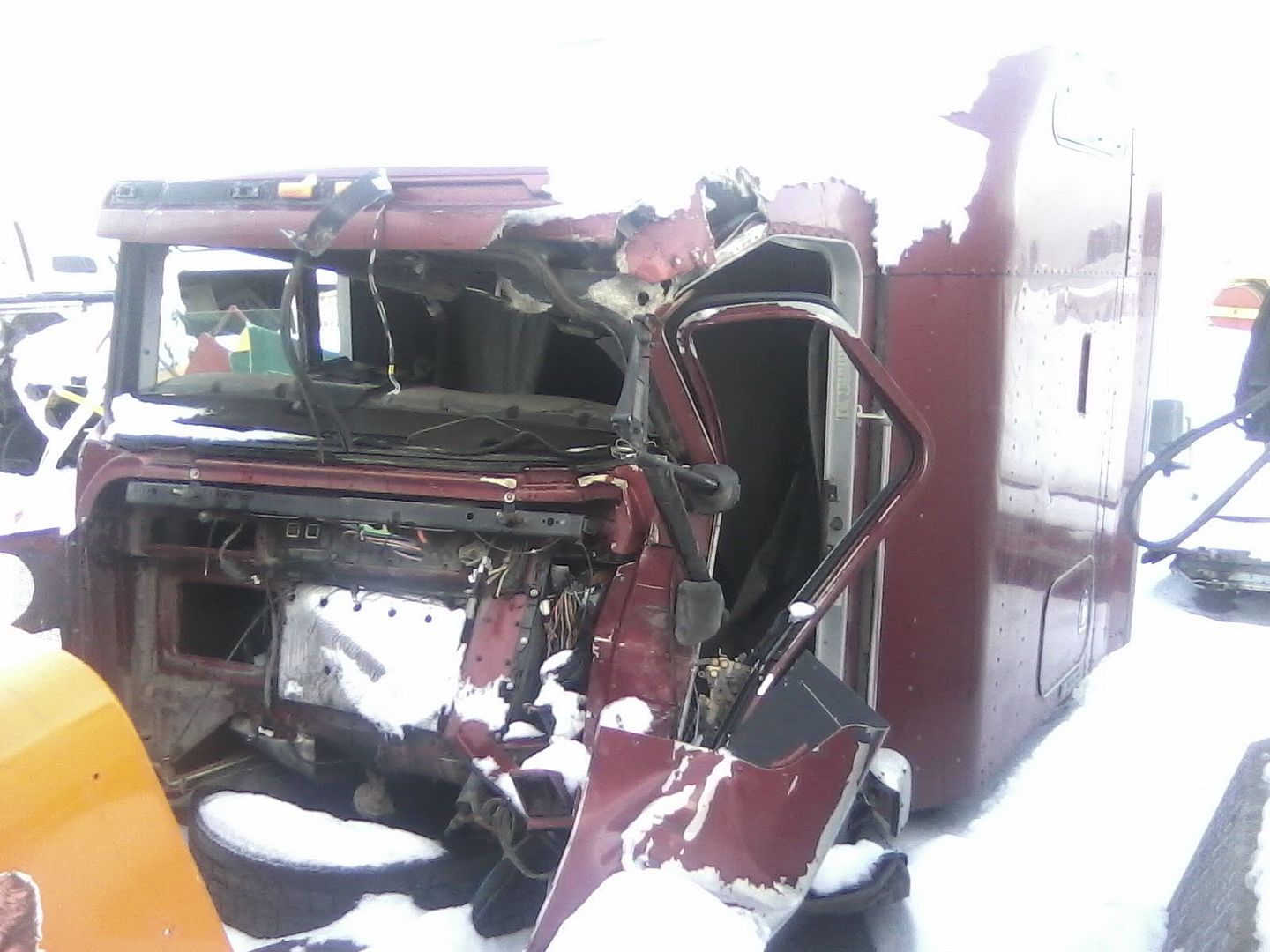

    The damaged cab removed from truck
    Things are not so bad driver said before

    Pablo , is this the truck that drove back?
    Experience has taught me that when there has been a mishap.
    Not so bad is often very optimistic.
    Had a drill rig damaged a few years ago that the driver who hit the bridge said was not so bad.
    He said just a couple of hydraulic hoses.
    US$ 250 000-00 to fix the not so bad.
