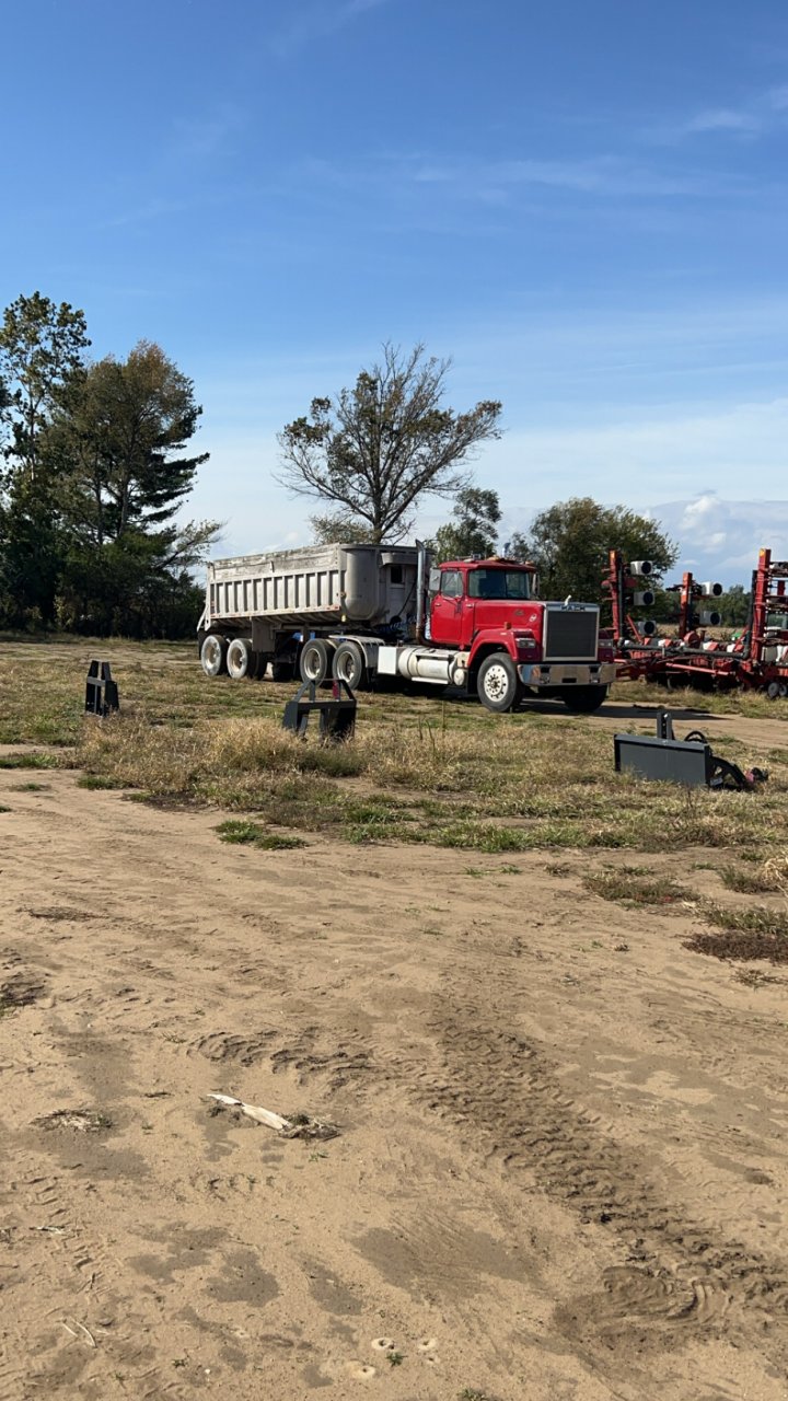

    Good afternoon fellow drivers, looking to go O/O this upcoming season 2025.
    I recently bought, and am the 2nd owner of
    1990 Mack Superliner
    E7400
    13sp road ranger trans
    22ft Fruehauf end dump trailer
    looking for tips and tricks from other drivers to prolong the life of the motor and trans. Everything seems to work real good!
    I bought it in Ohio, drove 5 hours home hypothetically doing 70 the whole way she ran like a top.
    Is it a good idea to add a transmission oil cooler? Or should I be adding some sort of additive every oil change like Lucas?
