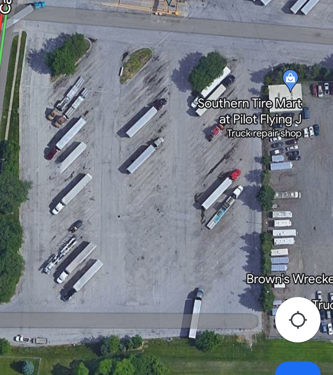

In this lot, putting the trailers in at an angle allows for a smaller aisle which allows an 6 rows instead of 5, the problem is half of them are on the blindside and as you can see about 20% are parked poorly, making life miserable.

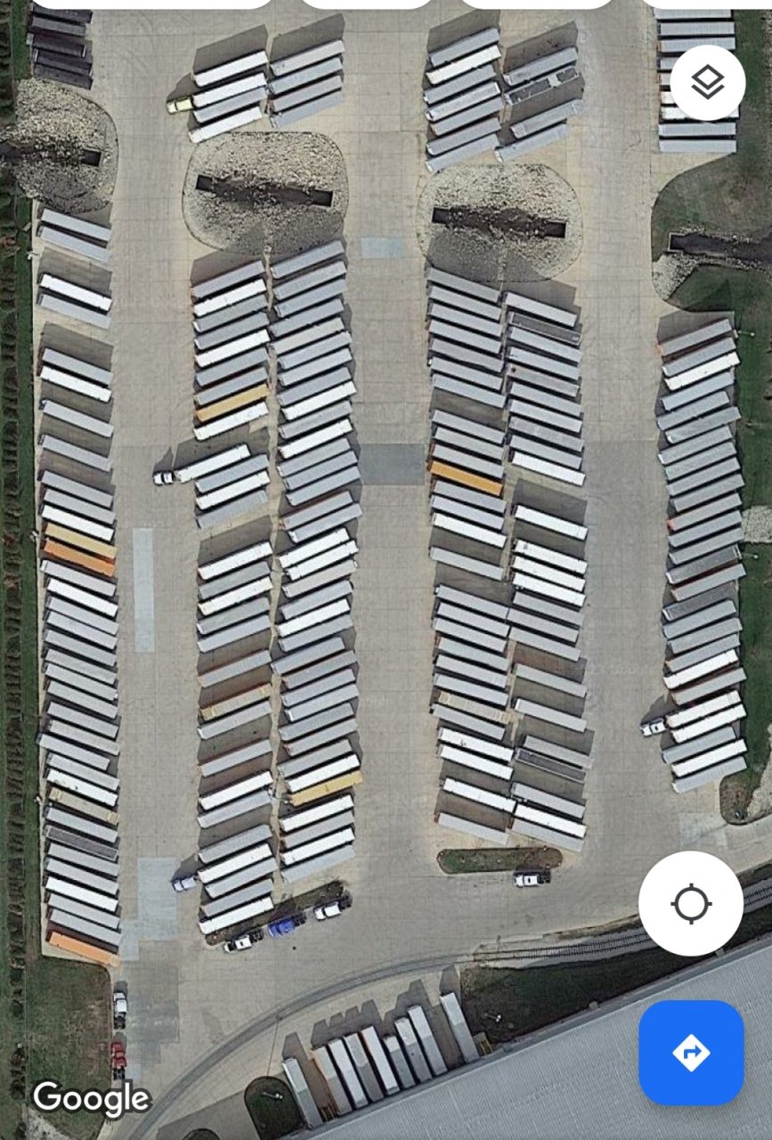

Here they put in angled "pull throughs". 15 spits per row, 3 rows, 4 aisles. If they'd just squared up the rows on either end and had them up against the curb they'd be able to get 10 more trucks in AND give everyone more room to work with.
If you have space for a 60 foot aisle and 80 foot spots on an angle, I'd just square them up. It eliminates blind side backing, gets more trucks into the same space, and reduces the number of guys you don't park correctly.Luther Morgan Thanks this. -
