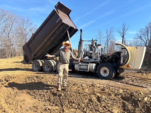

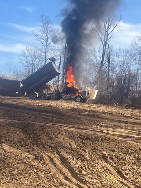

    Had a bit of bad luck Friday last. Another driver was dumping into reserve pit and smoke began boiling out from under hood and dash. He luckily got his cooler, paperwork and meds out before it became fully ingulfed, which took less than a minit and and a half. Had just enough time to roll hood over and shoot fire extinguisher and it was all on. Some something shorted about the firewall area and it went. I was being loaded about a quarter a mile as the crow flies on next ridge watching him dump when it started smoking. I was afraid to go over there right away cause it didnt look good as I didnt see him moving around the truck. Two years ago this coming April, I pulled into the yard late and found a longtime friend of mine dead at the wheel of that truck.

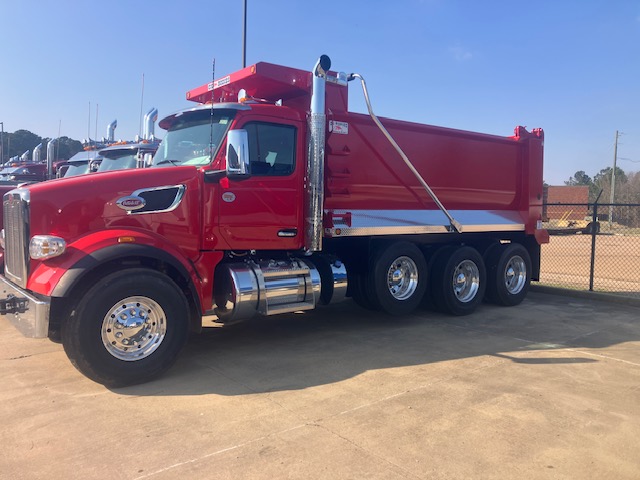

    Anyway I work for a Great company owner, (picture), he took it in stride. It was time to get another couple of trucks, and I was so honored to be invited to go with him to pick out a couple. Gonna get the red one and the twin to it, which are identicle to the white one I drive cept its a 2021. Hopefully get the pintle hitches installed Monday and be ready to regroup and et back to work. Needless to say a couple other drivers are smiling nice.
