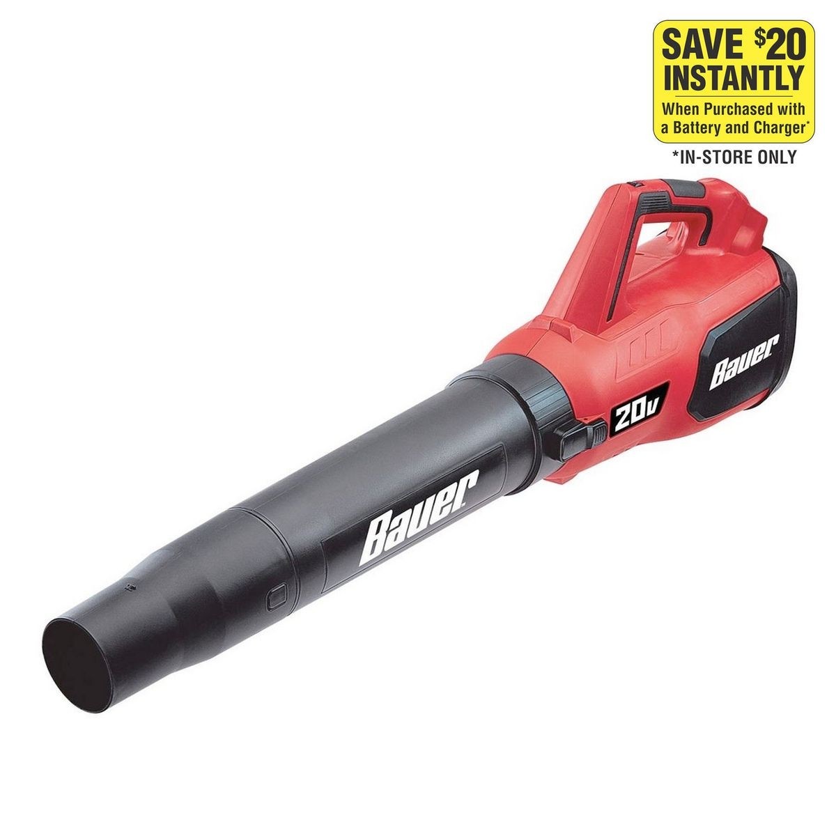

Another tip is to carry a cordless blower with you . This and coffee grounds like suggested above really helped me . Sometimes washouts are out of route and or backed up for hoursBTUTrucks, LoSt_AgAiN, Canadianhauler21 and 1 other person Thank this. -
