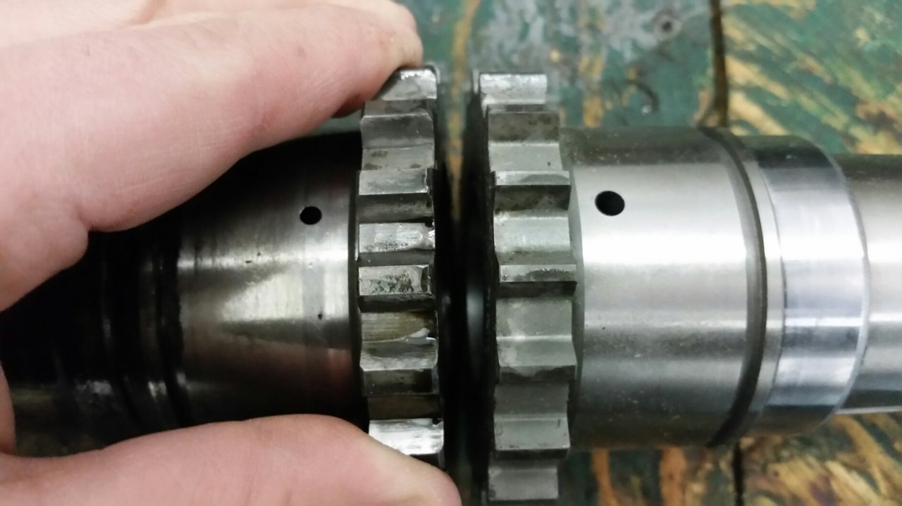

    I know Eaton went to an updated input shaft with thinner splines and it creates a little rotational slop between the input shaft and input drive gear. I was told by a gear shop that it'll cause a slight rattle with a PTO engaged. I can't see how idling along in low gear couldn't create the same effect. Idling along in low gear probably uses just as much power as a PTO.
    @Hulld I think you mentioned something about this at one time or am I mistaken?
    Bean Jr., Hulld, Coffey and 1 other person Thank this.
  9. AModelCat
    27,732
    145,339
    Here's a thread I started a few years back about the input shaft changes. Mine's an older 15 speed but I was led to believe Eaton made this update to many transmission models.
    Snailexpress Thanks this.

    Yes thats EXACTLY what mine is doing

    Hell there is a big difference in the teeth not much for tooth on the new ons
