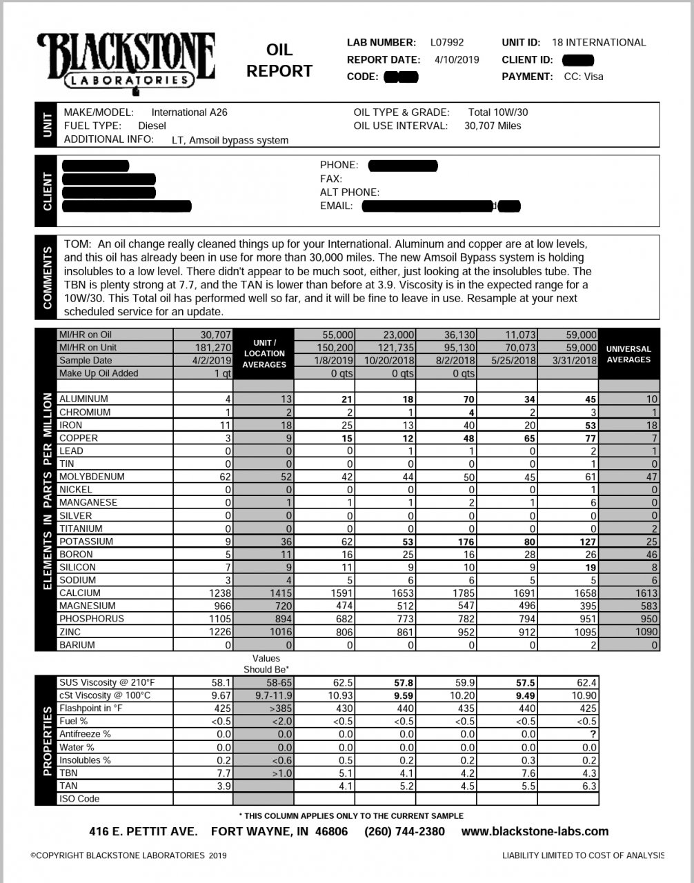

    Also, in the future, request TBN and TAN. What you have is good for seeing wear metals but to know if your oil is good or bad, you need TBN and TAN. Here is an example from Blackstone. It is much more detailed.

    Yes. I always spend the extra money and get TAN as well. Once TAN exceeds TBN, regardless of the remaining TBN, the oil needs to be changed.
