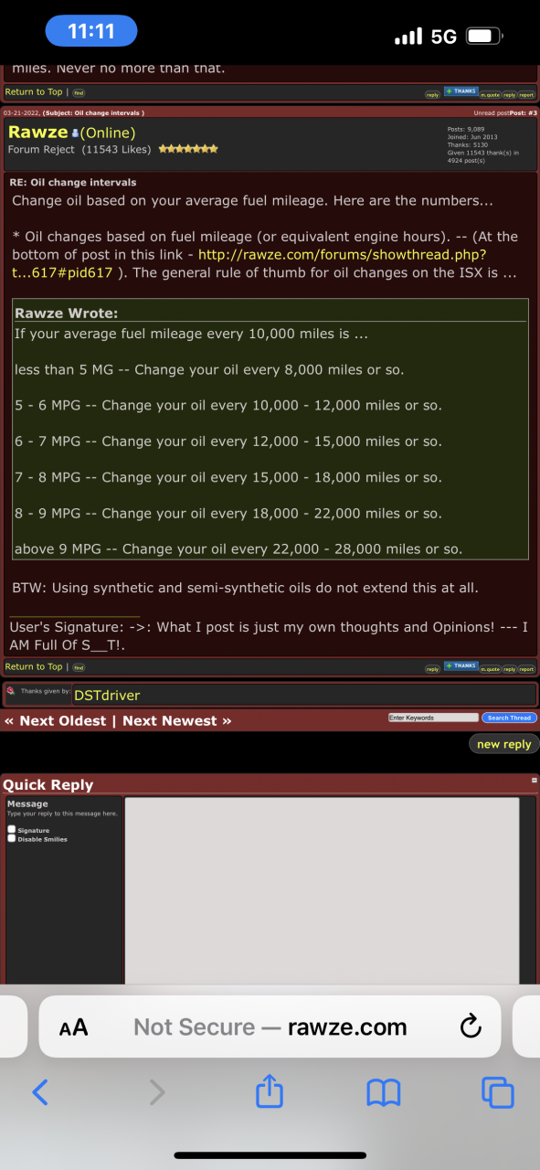

    That’s straight from Rawze the Cummins guru. 0DE7A28F-EEB4-40C4-B6FE-20267E8208C7.png
    Diesel Dave, baha, Xenergiserx and 4 others Thank this.

    8000 miles?
    what a waste of oil.
    try 18,000 miles with a OA.
