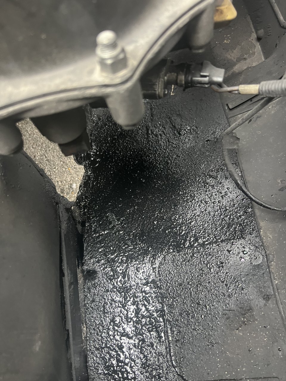

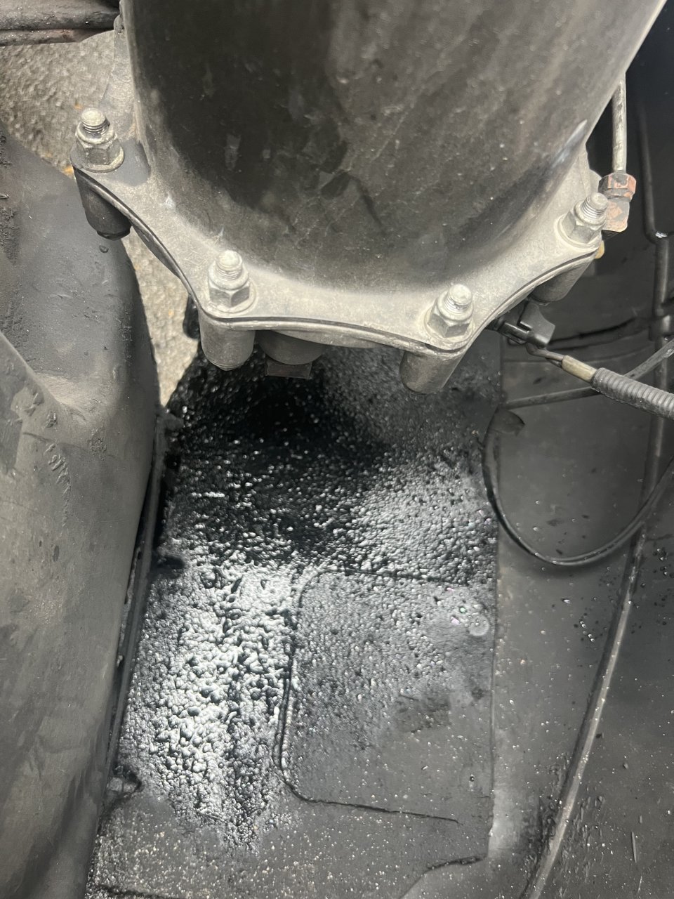

    I appreciated any help less than 3 months changed 2 air compressors and still pushing oil replaced air dryer bypass the intake hose still pushing oil it’s Detroit 12.7 pre egr and the 2 air compressors was rebuilt from freightliner
  11. AModelCat
    29,785
    165,648
    Is it coming from the compressor or is it picking it up on the inlet side? Been a while but I seem to recall those Detroits picked up the inlet air from the intake but I can't remember if it was pre or post turbo.
