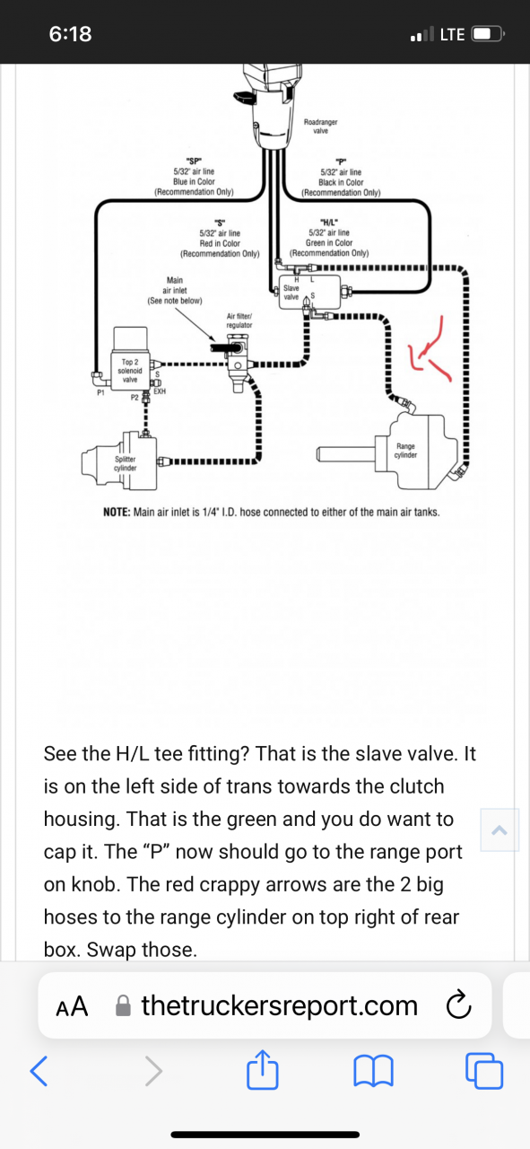

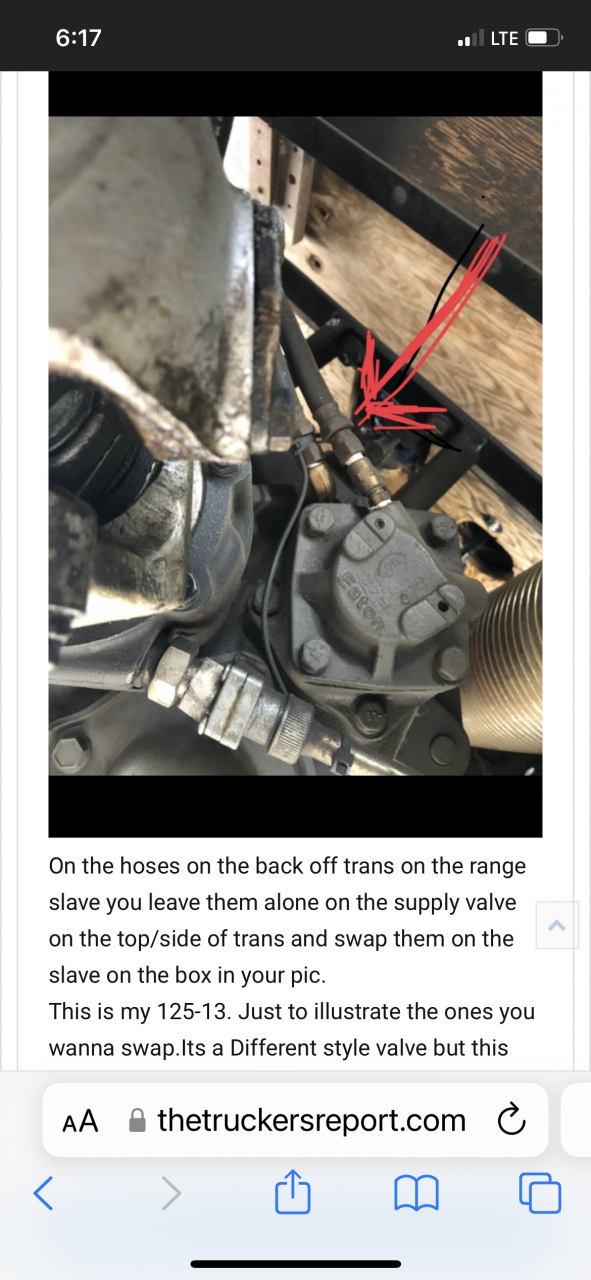

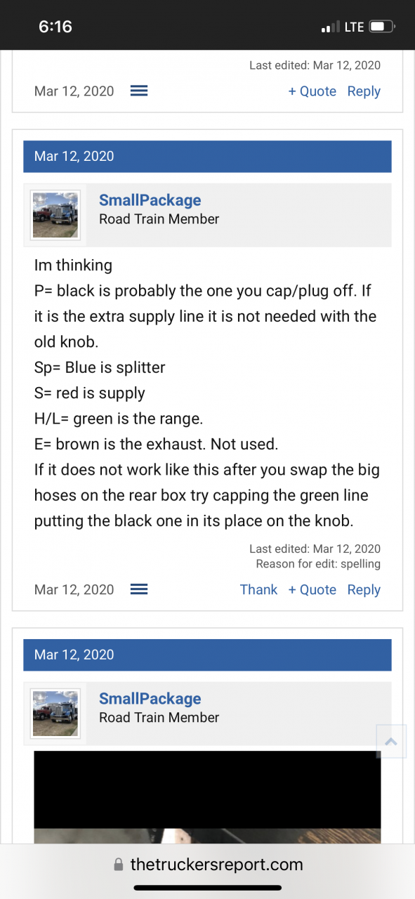

    51D98B61-05E9-4827-8C96-EBF3078E5612.jpeg I’ve got 13 speeds in a couple of my trucks and I’ve put the old style shift knob, in both of them. Can an 18 speed be outfitted with this shift knob? There’s only 4 air ports in the 13 shift knob, would an 18 require a 5th to accommodate the low range splits?

    Ok, bear with me, it’s been a few years. Here’s some pic I found, that Smallpackage, helped me with. 419F837D-D859-440B-8818-32A9F827A7CC.png A014144F-3663-45A9-90D7-D46092109097.png 3F367583-11AB-40D1-836F-EE9C3CC7D3A6.png
