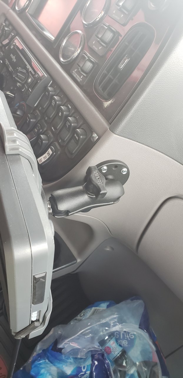

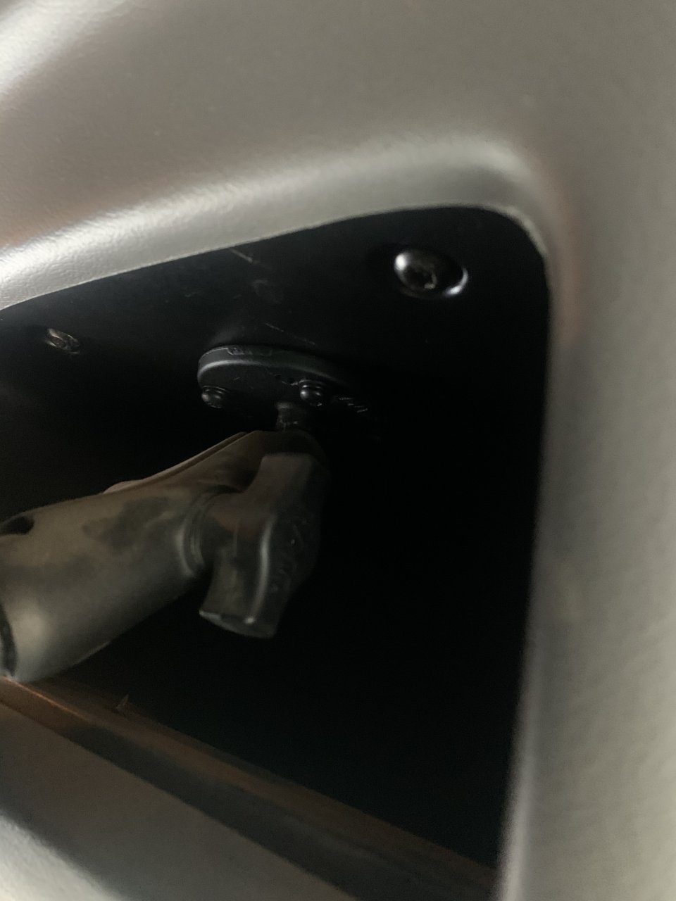

    You won't like mine as it includes screw holes in the dash but atleast you get the idea. LOL... My buddy also has the same truck and he mounted his down by the cup holder, also screwing through the dash but more "hidden".

    Have a couple that are mounted to the bottom of the cup holder. Puts the unit lower but no holes can be seen when removed.

    @JonJon78
    That’s exactly where I was thinking I could do it but was afraid of covering some of the switches.
    I may just put it there and be done with it. I’m not against drilling holes, just want to get it done right the first time.
    I really appreciate you taking the time to reply and post pictures.

    No problem. Not sure if the 2021 389 has a vent right below where the cup holder is or not? But that's where I ran the cord through from underneath the dash.

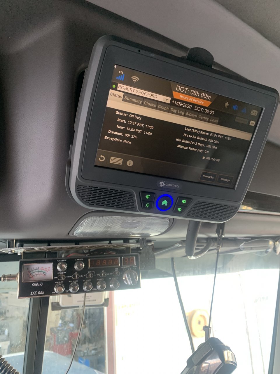

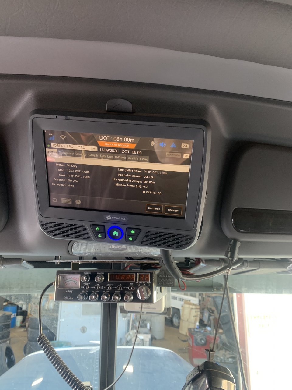

    I pulled the upper trim down and mounted mine in the center above the light, ran the cord out from under dash behind the cup holder.

    That’s a good place for it, thanks for the pictures. I never thought about putting it up there.
