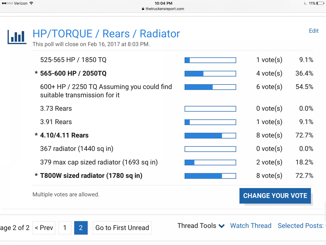

HP/TORQUE / Rears / Radiator
Poll closed Feb 16, 2017.
  1. 525-565 HP / 1850 TQ
    0 vote(s)
    0.0%
  2. 565-600 HP / 2050TQ
    52.0%
  3. 600+ HP / 2250 TQ Assuming you could find suitable transmission for it
    48.0%
  4. 3.73 Rears
    8.0%
  5. 3.91 Rears
    28.0%
  6. 4.10/4.11 Rears
    56.0%
  7. 367 radiator (1440 sq in)
    0 vote(s)
    0.0%
  8. 379 max cap sized radiator (1693 sq in)
    32.0%
  9. T800W sized radiator (1780 sq in)
    64.0%
Multiple votes are allowed.
