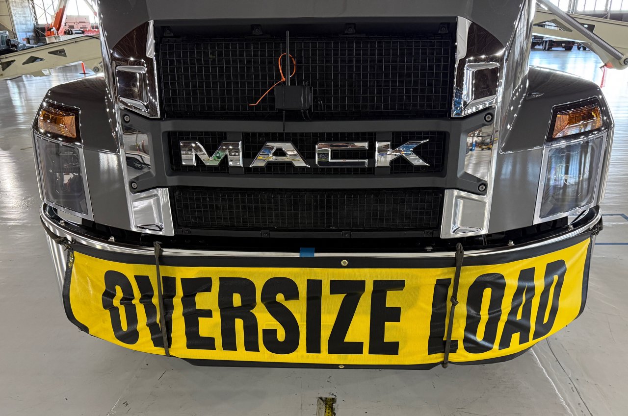

    So as the title goes, what banners are y’all using for radar equipped trucks. The Mack I use for the California gig has all the safety gizmos and it doesn’t like it when I block them with a typical banner. Ie check light on the dash.

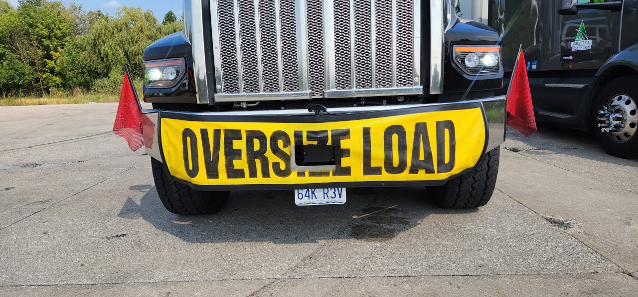

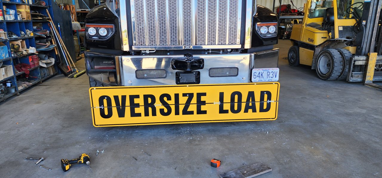

    I have a similar issue. Akron scale on I-76 tried to pull my permit for cutting a hole in the banner saying it was unreadable. I wound up just doing a flip down aluminum sign mounted below the radar.
    The sign is attached to a piece of 3x3 aluminum angle bolted to the bottom edge of my bumper.
    It does get a bit banged up but at $130 a piece I just replace it when it starts looking too bad.

    That’s a thought although this Mack has a curved bumper kinda like your Western Star.
    I got like 41 inches before the curve gets ugly. I don’t think these guys will go for a bar sticking out to trip people.

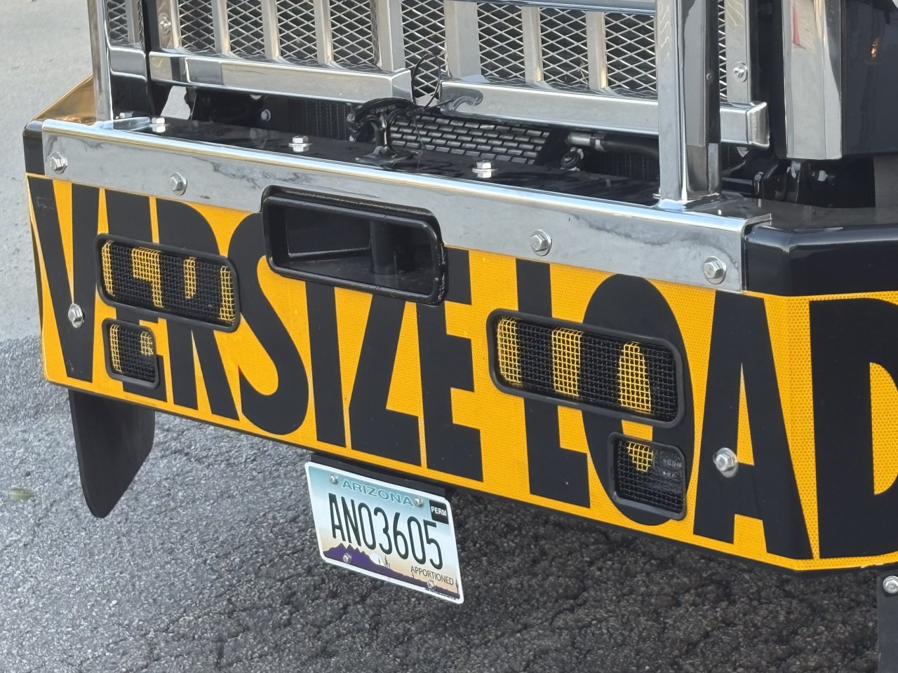

    Yea its tough with the tapered/curved bumpers. What about wrapping the bumper directly like @Rontonio did?

    I order the vinyl pre-done reflective and then painted the grills for the penetrations the appropriate color ((actually my super talented steerman did it)
    the vinyl as as like $200 or so and the company did the application for about the same
    I have been running Ohio for the last couple months and no one has said boo

    Man! I like that but I made the mistake of reading California rules. I know. Why? No one cares. But like cover up your beacons when not in use. Not supposed to run a sign without a load. I honestly don’t know how often this will even happen with this gig. But that is sweet!

    Just do up a cover - that is what we did - turned the banner around so no words would show and then Bungee
    doing up a cover in black material would be a snap
