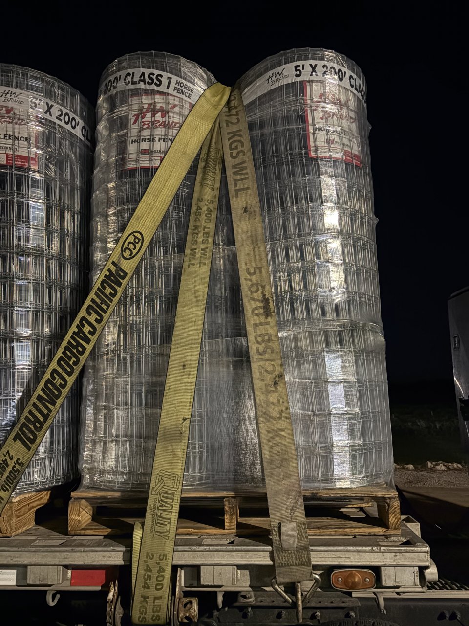

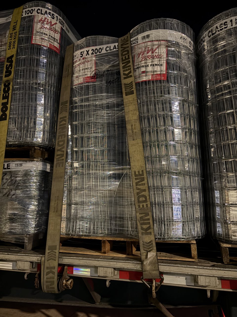

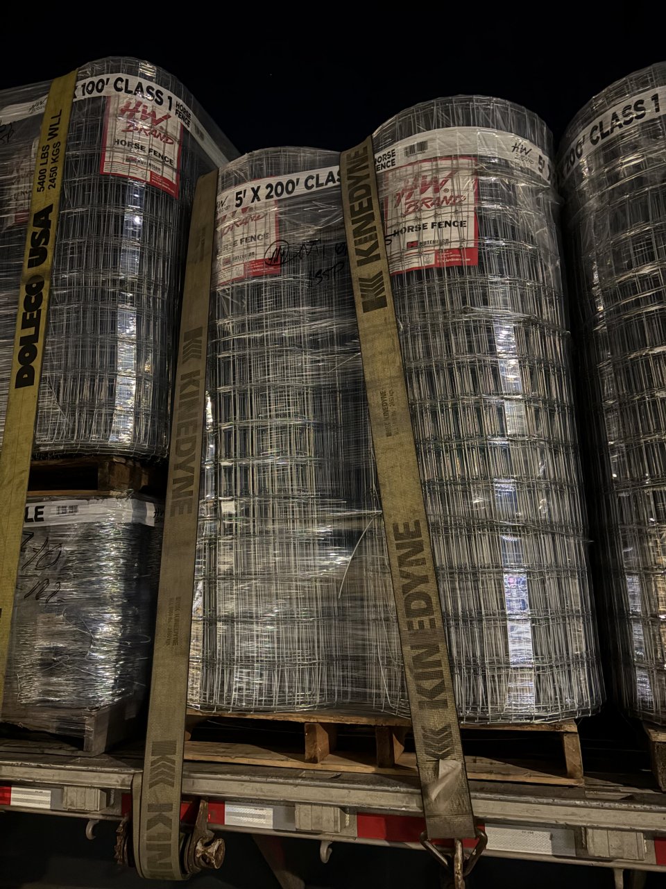

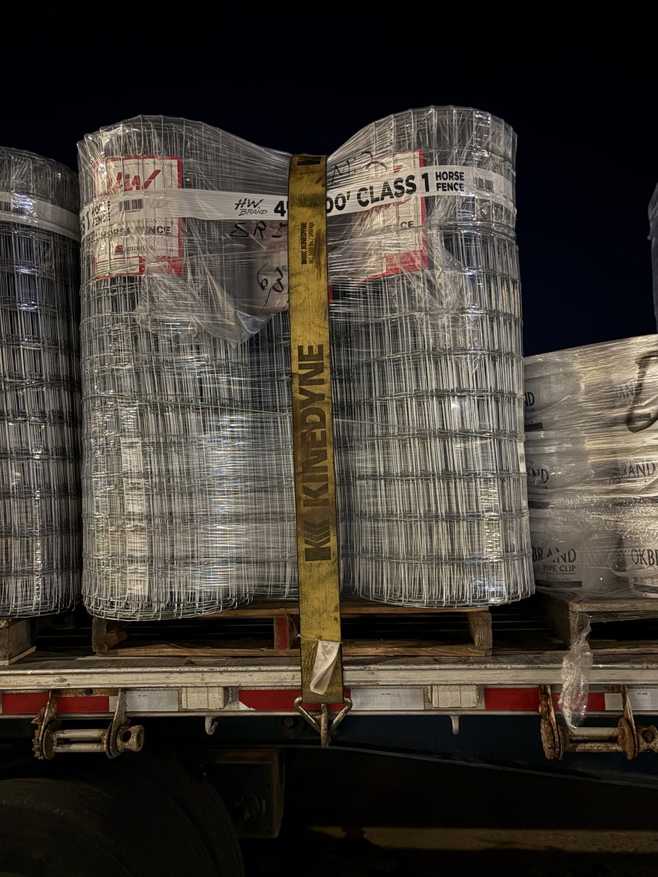

    New flatbed driver here (come from van/reefer). Just picked up a load of palletized welded wire fencing - 33,000 lbs total. Each pallet has 4-6 rolls of fencing stacked two high, and everything's shrink-wrapped.
    My problem: When I tighten down my straps, they keep sliding down between the round fencing rolls instead of staying on top where they belong. I'm worried the shrink wrap won't hold this load secure for the 800+ miles I need to haul it.
    Looking for tips from experienced flatbed drivers who've hauled similar round/cylindrical loads. How do you keep your straps positioned properly? Any special techniques or equipment I should be using?
    45 degrees across the top? Even that wants to slide between
    Thanks in advance for any advice!

    2x4's across the top, or pallets. This will hold your straps in place and provide even pressure when you tighten your straps.
    Be sure to stop shortly after you get going to tighten things up as you will have some "settling" occur with that load.
    I usually stop in the first hour of my trip to check everything.

    What I would say, dunnage across top.

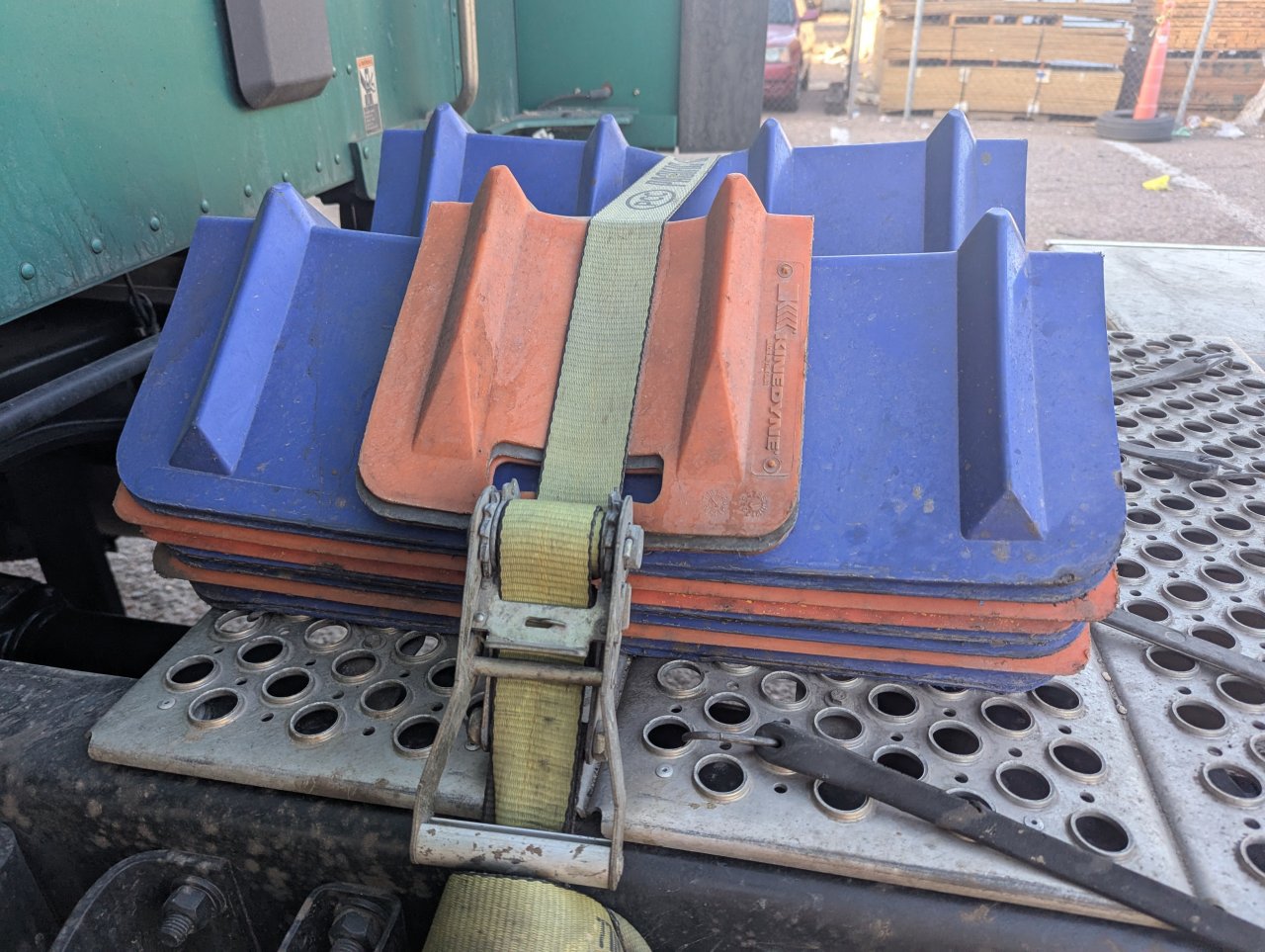

    You need v boards... That load is going to come tumbling down off the side of your trailer when that shrink wrap lets go..
    They make longer ones than these that would work
    The way you have it now, i would individually strap the rolls themselves. So atleast its secure. The way you have it now is not good.
    You need some kind of edge protection underneath those straps as well, that fencing will cut the #### out of them and then youre really up a creek..if you have none of that you be better off tarping it the way it is .. im not kidding either. You need to right equioment to do flatbed work, this is dangerous and you putting alot of peoples safety at risk.. but atleast u are asking questions that is a good thing

    I'd cut up a couple old belts and make corner boards. 4' or 8' 2x4's held in parallel by a foot of belt nailed to each, near the ends. Drape em over the outside edge
    If theres nothing else available where youre at, you could try crossing a pair of belts for each pair of skids. That may work a bit better than straight over
    I haul that stuff often without anything special, but its usually only a skid or two but they band the rolls together with steel straps so theres little chance of the bundles coming apart

    The V boards suggested are spot on. Makes all the difference on a load like that.
    I used regular edge protectors. It was all I had, and I was new at this. Dunnage never even crossed my mind

    I am pretty sure those rolls are wire-tied together in addition to the shrink wrap. So that will help, but yeah you will definitely want some V-boards for next time.
    Also, put a twist in your straps to help prevent them from flapping around and working themselves loose. A couple x-straps across the front wouldn't hurt either.
