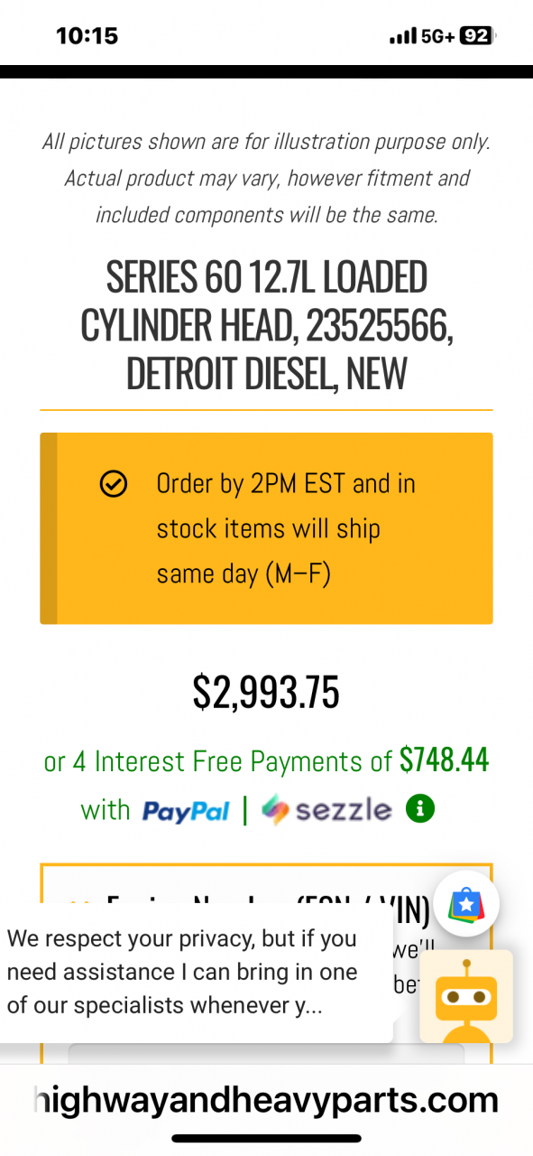

    I see a few places selling them. HHP comes to mind. I don’t know who makes them. I’m guessing they’re all the same Manufacturer. Advertised as higher nickel and larger cooling jackets. Last time I priced them. It was about $3400-$4000 for either reman DD or New aftermarket. That was within 2 years ago. In 2000 I paid $2300. The price gouging is getting way out of hand. $5700 is crazy. $1200 for $500 worth of gaskets and bolts? Wow!!! I’m considering going aftermarket if I need one. Not real impressed with DD reman. I imagine every single one of them have been repair welded. The problem with aftermarket reman has been milling them too much. That’s from DD analysis. When you buy a reman, they want the core. Doesn’t matter what brand or who did the reman. They want to research it. Same with Rod/Main bearings. Brand new, no core or deposit.
