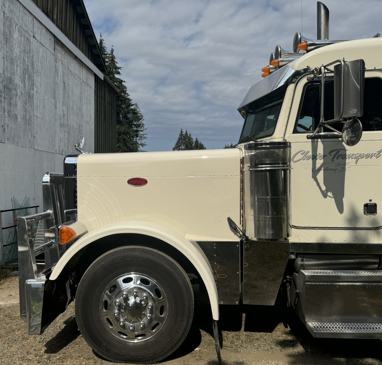

    Got a 2004 peterbilt 379 exh, the hood was replaced prior to me buying it.. was just starting to notice that it has a considerable slope compared to slopes on other 379( i know they all have a slope ). Was looking at the front 4 bolts that have washers on them and notice that the front bolts have 4 washers and rubber bushings, while the rear ones only have one.. picture is attached, let me know if this not adjusted properly, and how to make it right.

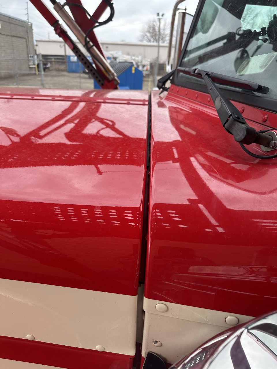

    I noticed my 389 had a larger gap than usual so I started digging around for the reason. I found that the hood rest bumper on one side wasn’t fitting properly and eventually fell off. I replaced them and have had no issues since. The gap between the hood and panel over the firewall was large enough for rain to get down in the engine compartment. Now it is a normal gap. I found the parts on Amazon drastically less than at the Pete dealership for the same plastic part. IMG_2399.jpeg IMG_2398.jpeg

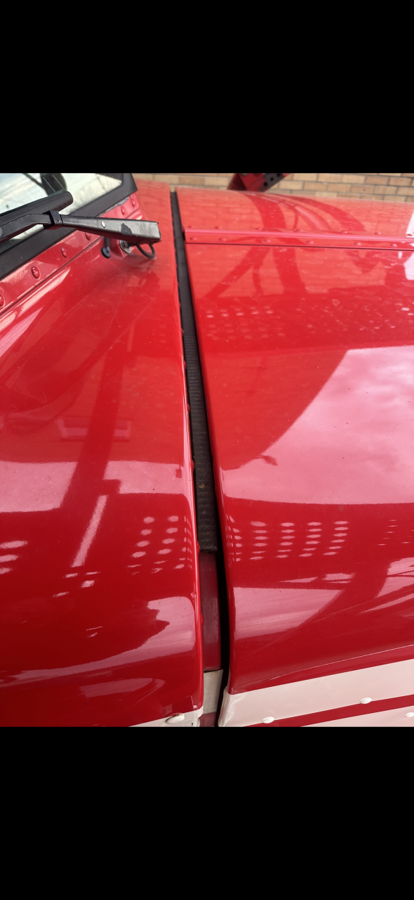

    Before and after photos and the gap should affect your hood slope. IMG_1411.png IMG_1410.jpeg

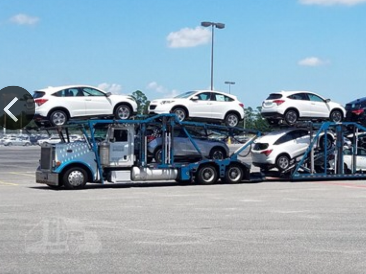

    I noticed 2015 car carrier ( I believe I am right with year ) my neighbor has no slope compared to 2000 car carrier , both trucks short hoods , but I measured lengthwise and his hood probably 4 inches longer .

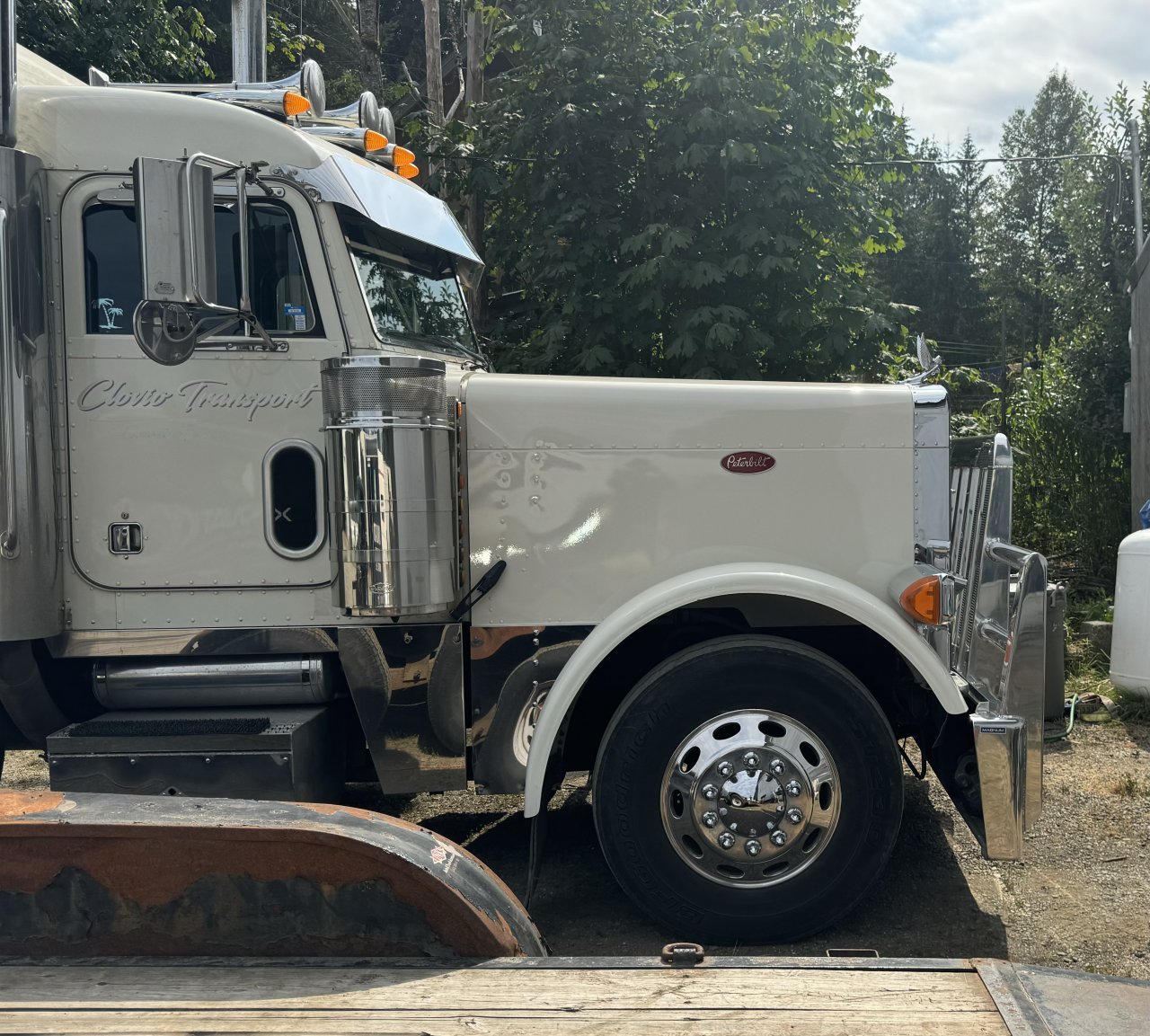

    Many car carriers were the 388 which had a sloped hood and was made until 2015. Mine which was also built in 2015 is the 389 with the slightly longer hood compared to the 388. The blue and white rig looks like a 388, but the hood slope is what I am referring to. IMG_9735.png IMG_2598.jpeg

    Thats what I starting thinking that it was a conversion, but everything else says its a 379 exhd hood, it would have many differences other then just a slope.. im still thinking it isnt adjusted properly.. just dont want to start messing around without confirming
