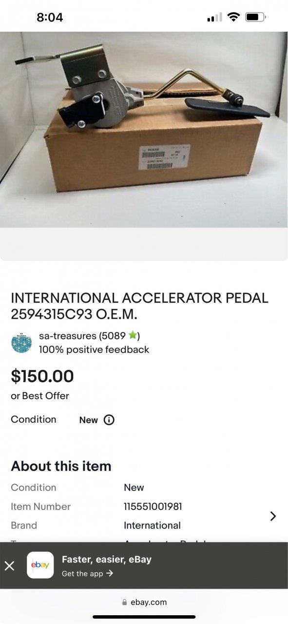

Should we have used an international brand part? We used a cheaper one…

Who’s the manufacturer of the Aftermarket part? -
Actually it was international, I thought it was an off brand but I was wrong... I have attached an image. Please review it and tell me what you think. Thank you for helping us. I have to figure this out.
Any other ideas?Attached Files:
